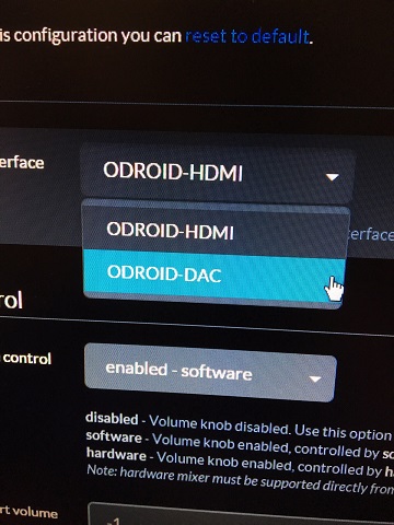

Postby smallfat » 10 Apr 2016, 05:40
I believe ODROID can help you.
It has separate I2S output connector.
Best Regards
檔案 3-4-2016 06 51 59s.jpg (67.09 KiB) Viewed 2810 times
