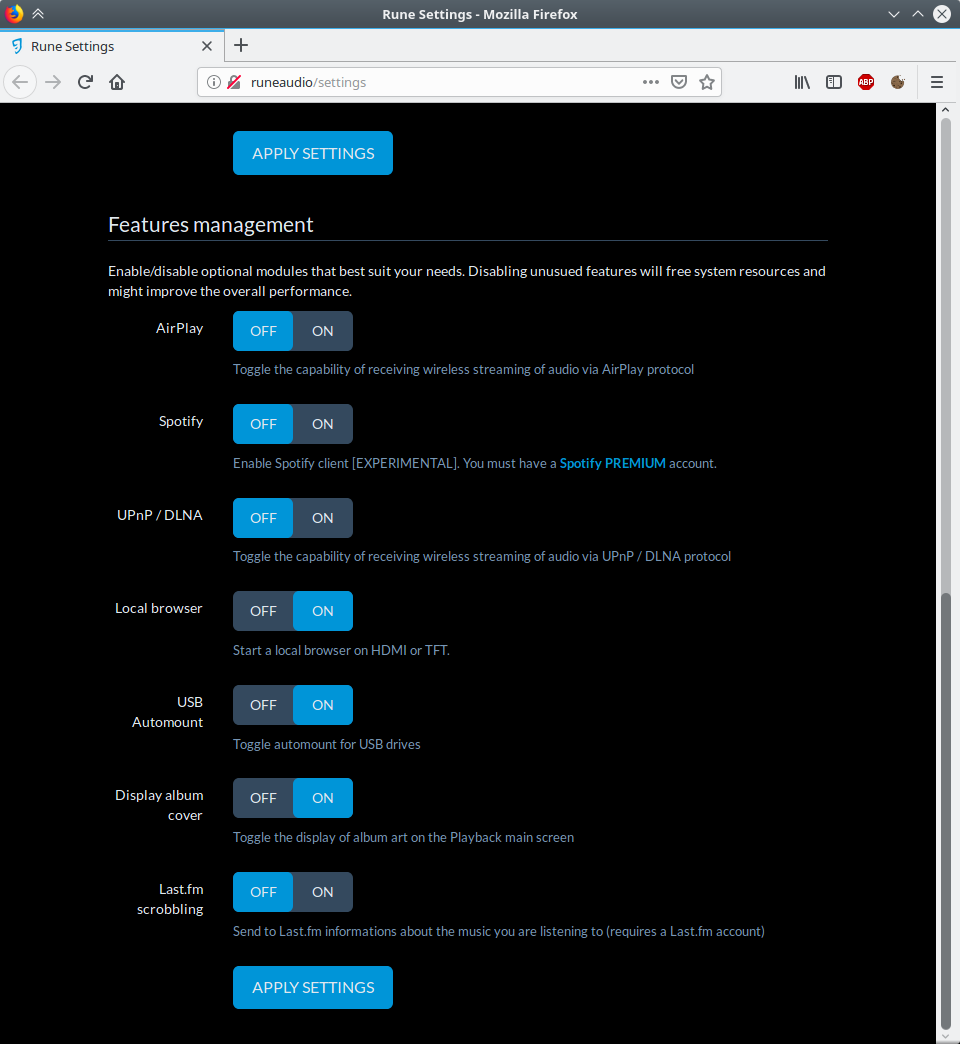

Postby mlaky » 28 Mar 2019, 11:37
I don't have that option...
Rune Settings - Mozilla Firefox_201.png (70.42 KiB) Viewed 3346 times
