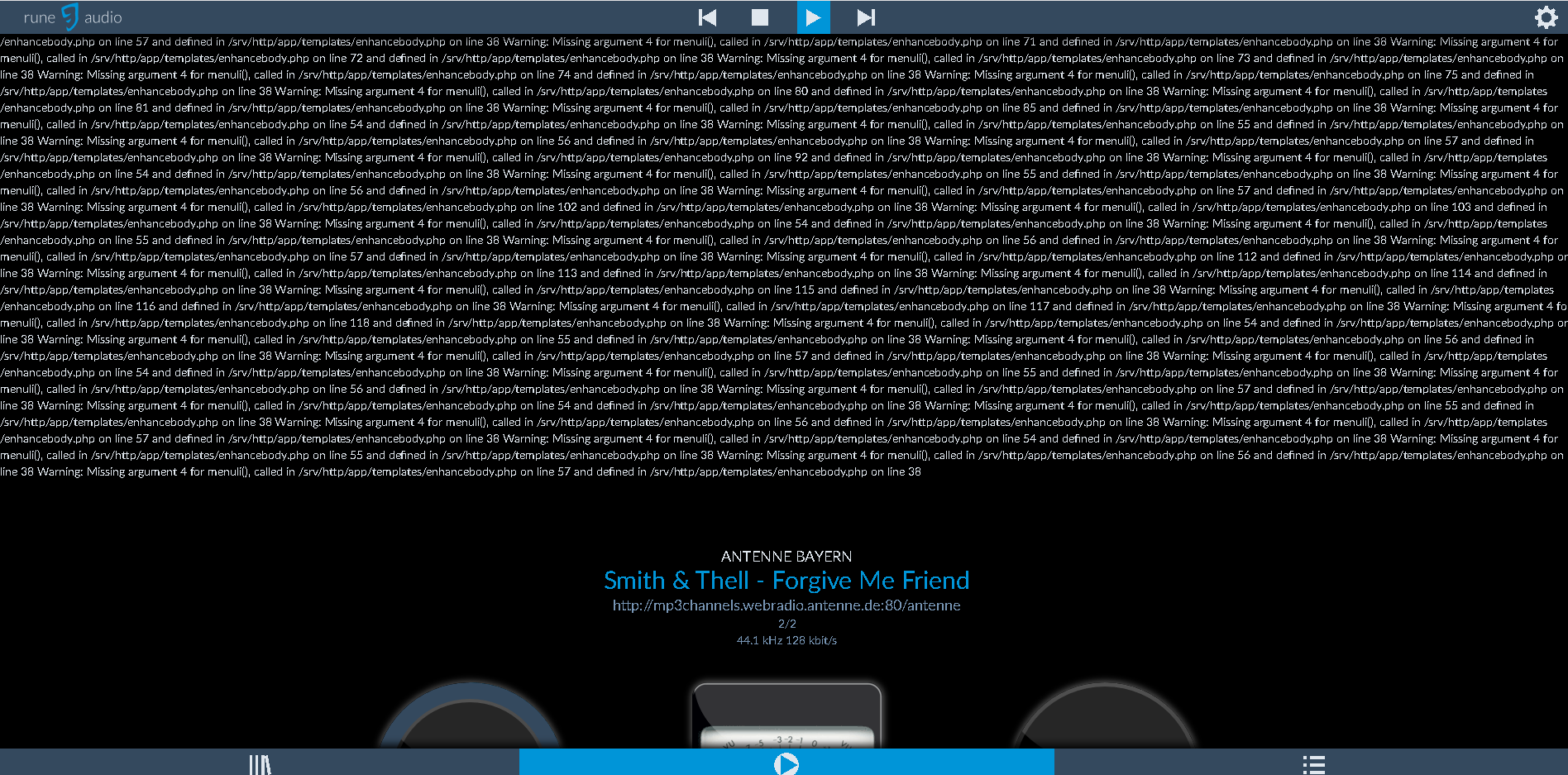

I´ve got an issue with "Debug"-Infos from Dev.-Menu. If you activate them, following output is thrown:
So I think, there´s something wrong ;) ;)

Postby rern » 09 Feb 2019, 13:28
Hi Andy,
Many items in Development page should not applicable in RuneUI Enhancenent. The debug option is one of them. They will be hidden in next update.
