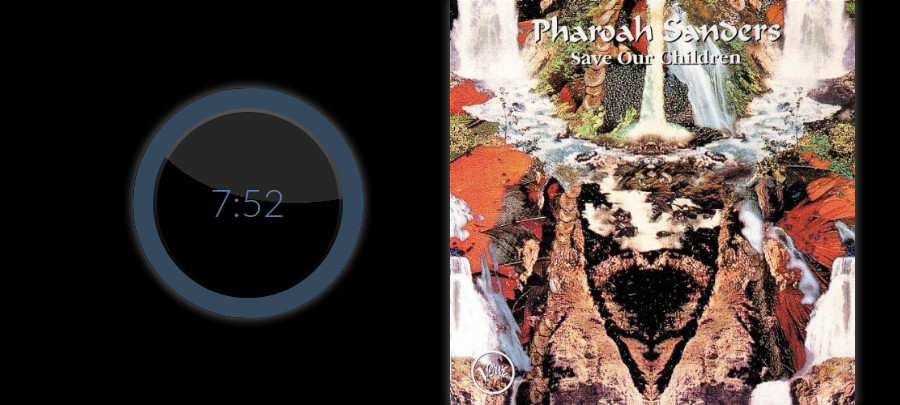

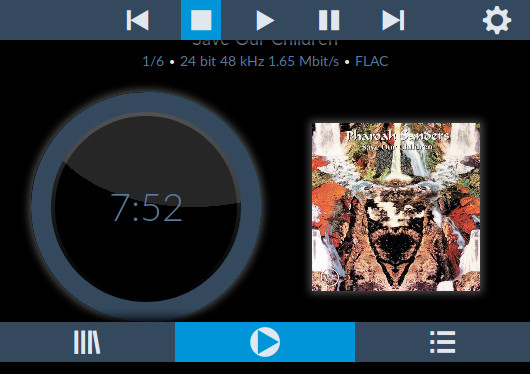

@klassikmann
It's cover art scaling bug.
