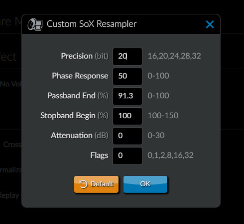

Re: RuneAudio+R e6
Postby rern » 11 Nov 2020, 14:20
@R101,
SoXR not working? It's already been there with setting: quality "very high".
Custom setting was added to MPD recently. It'll be available on R+R e6 soon.
Can you or someone verify the default Passband End value as 91.3?
Actually, I have no clues for all of them. Please share why tweaking them improves sound quality.
Re: RuneAudio+R e6
Postby R101 » 11 Nov 2020, 17:59
rern,
Thanks for the reply.
The problem is that if you add the format "sample rate:bit depth:channels" line to mpd.conf, and restart mpd, it only works until the next reboot, when the mpd.conf file is overwritten.
I am quite happy to have the Very High quality setting, and would not know enough to customise it.
