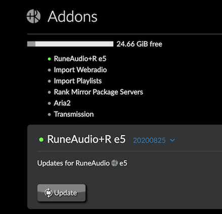

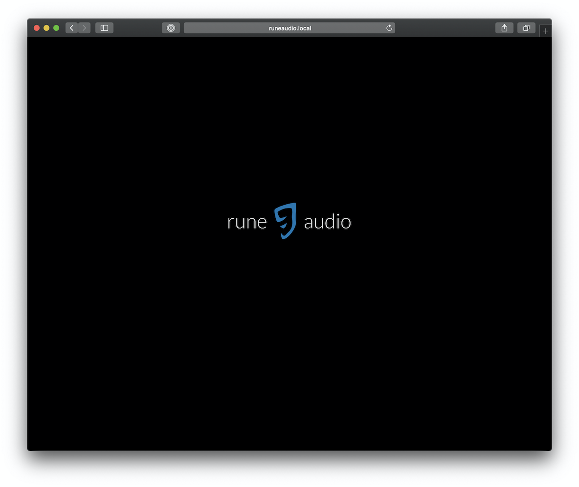

e5 seems to be working fine running latest updates (as of yesterday's installable update) for streaming spotify and airplay, and I can reach settings if i manually type the URLs in teh browser, but via the browser going to "runeaudio.local" all I get is this. I can't seem to get the regular display to browse my library, etc.
RuneAudio+R 2020-08-27 19-57-35.png (167.67 KiB) Viewed 2684 times

Re: RuneAudio+R e5
Postby cmh714 » 28 Aug 2020, 03:12
cmh714
Posts: 470
Joined: 04 May 2014, 03:06
Re: RuneAudio+R e5
Postby cotriumph » 28 Aug 2020, 20:12
I'm already on the latest version, hopefully, this gets sorted soon because it's unusable for me now.
