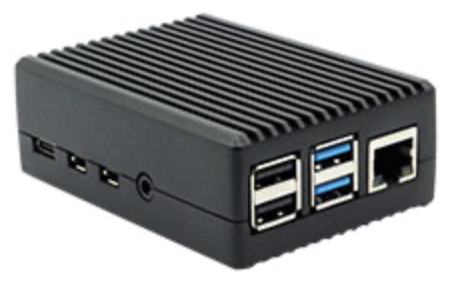

Postby Reliang268 » 17 Jul 2020, 05:42
Hi Rern,
Update 20200716
The Regulatory domain setting at Wifi is gone. How to get is back? Am I able to downgrade it to previous version?
I suggest as this is a headless player and so wifi should be always “ON” and should be anytime when the wifi ip loss connection will automatically connect to AP mode (unless ethernet is connected). At AP mode if able to scan and connect to wifi ip address for reconnection again.
Thanks,
KM
Reliang268
Joined: 01 Jul 2020, 03:07
Re: RuneAudio+R e4
Postby Reliang268 » 17 Jul 2020, 06:02
Passive heatsink case
