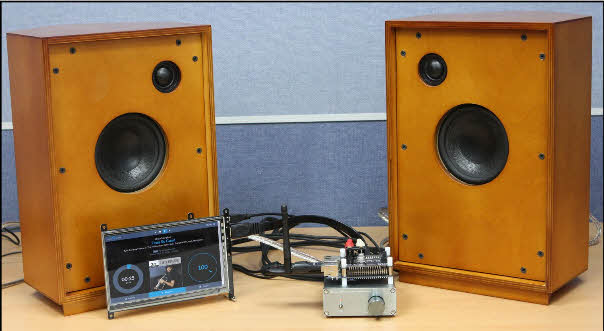

Re: RuneAudio as a standalone system on C1+
Postby ak37 » 09 Oct 2015, 21:35
It's working!! Odroid c1+ + shield hifi + FirstOne dit amp (lazycat diyaudio) ;)
Postby odroider » 10 Oct 2015, 02:10
Congratulation!
You have a great AV system.
BTW, could you manage to enable the DAC output instead of the HDMI audio?
It should be possible with the Settings menu.
Postby ak37 » 10 Oct 2015, 07:59
Oh damm... I enable the Hifi dac in /boot/boot.ini but I forgot to select it in setting of runeaudio... Sorry !
Now It's working perfectly, just some bug like the choice between mpd or spotify always propose me...
Thank's for your help !
Postby odroider » 10 Oct 2015, 09:06
You are welcome.
Happy to see the giant Rune-UI on your big TV. :D
