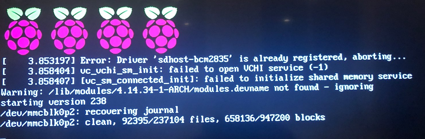

Postby leardo » 08 Jul 2019, 03:51
Hello all,
Wondering if i could get some help installing the latest so it will work with the 3B+ model.
/i get the following messages and Rune never starts.
I've attached an image of the screen. Any help is appreciated!!
Mike
Screen Shot 2019-07-07 at 10.49.47 PM.jpg (157.19 KiB) Viewed 3484 times
