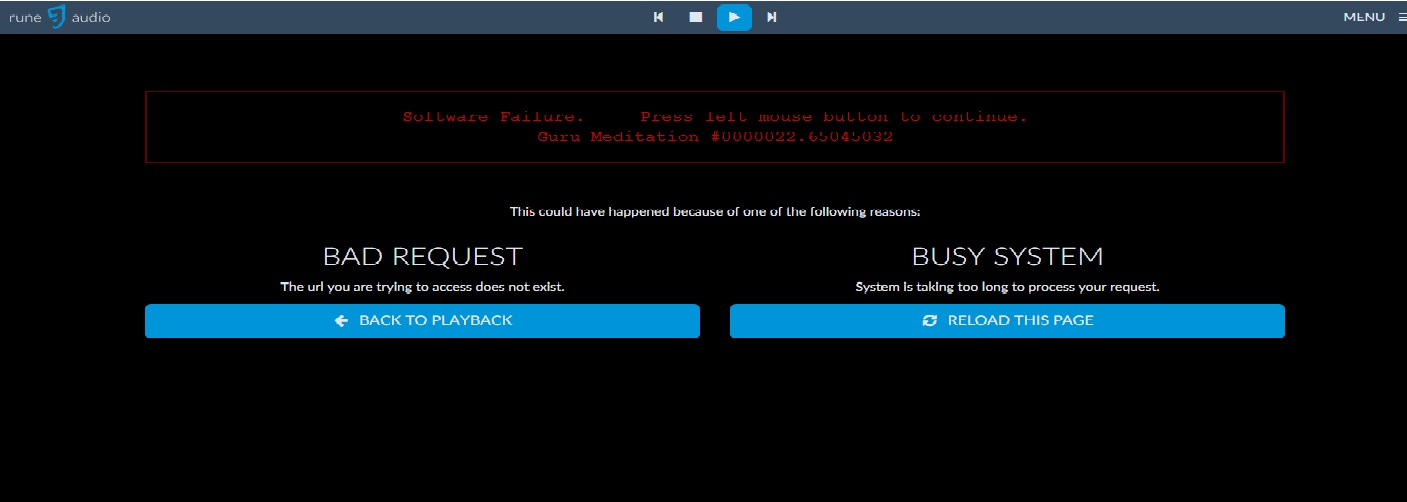

A while ago , I did a gitpull , rebooted and everything was fine . Today I found that devmode seems to be kaput . I get Guru Meditation #0000022.65045032 errot . Any ideas what is going on ? Everything works fine apart from devmode :)
