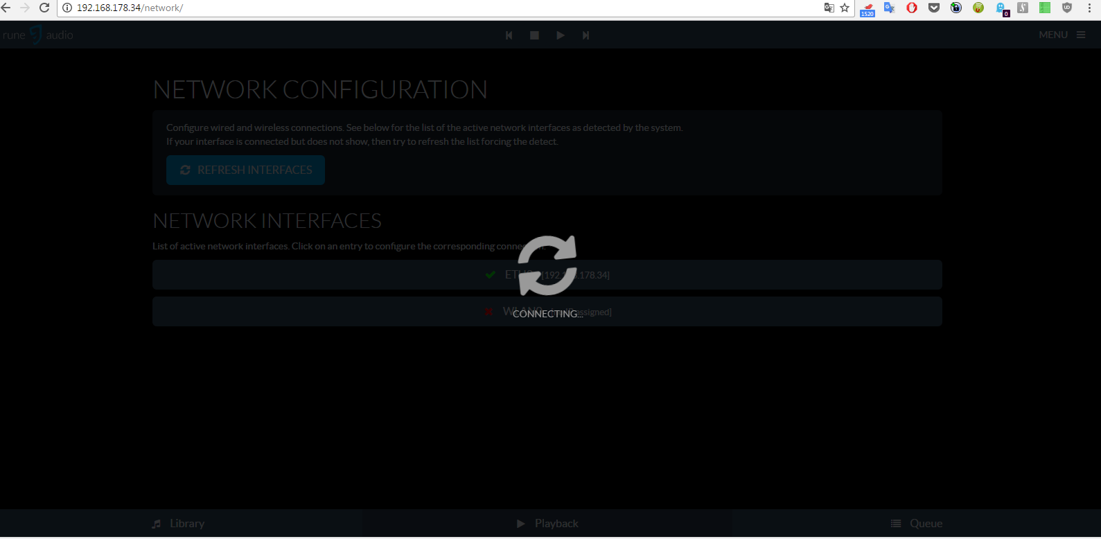

I installed RuneAudio (the last version from your download site) on a Raspi3 with a HifiBerry Dac+ card
The system boots fine
But the UI loops (see screenshot)
on the /dev site i get the message
WARNING
The loading layer (spinning arrows) points to a socket error
My debug output:
http://pastebin.com/Kc8f2NcN
Any idea?
A workaround or something?
Do you need more informations?
thx
2016-11-12 10_13_30-RuneAudio - RuneUI.png (51.61 KiB) Viewed 2804 times

Hi tbee,
please try to temporarily disable all popup blocker and the firewall on your computer.

thx a lot with another Windows10 PC and Firefox i get no loops
With my laptop it loops in every browser - I think my Kaspersky Scanner is the problem (I cant try this exact because its a business laptop and I have not enough rights to disable it)
[By the way it is not a generall problem of my laptop - volumio works fine]
