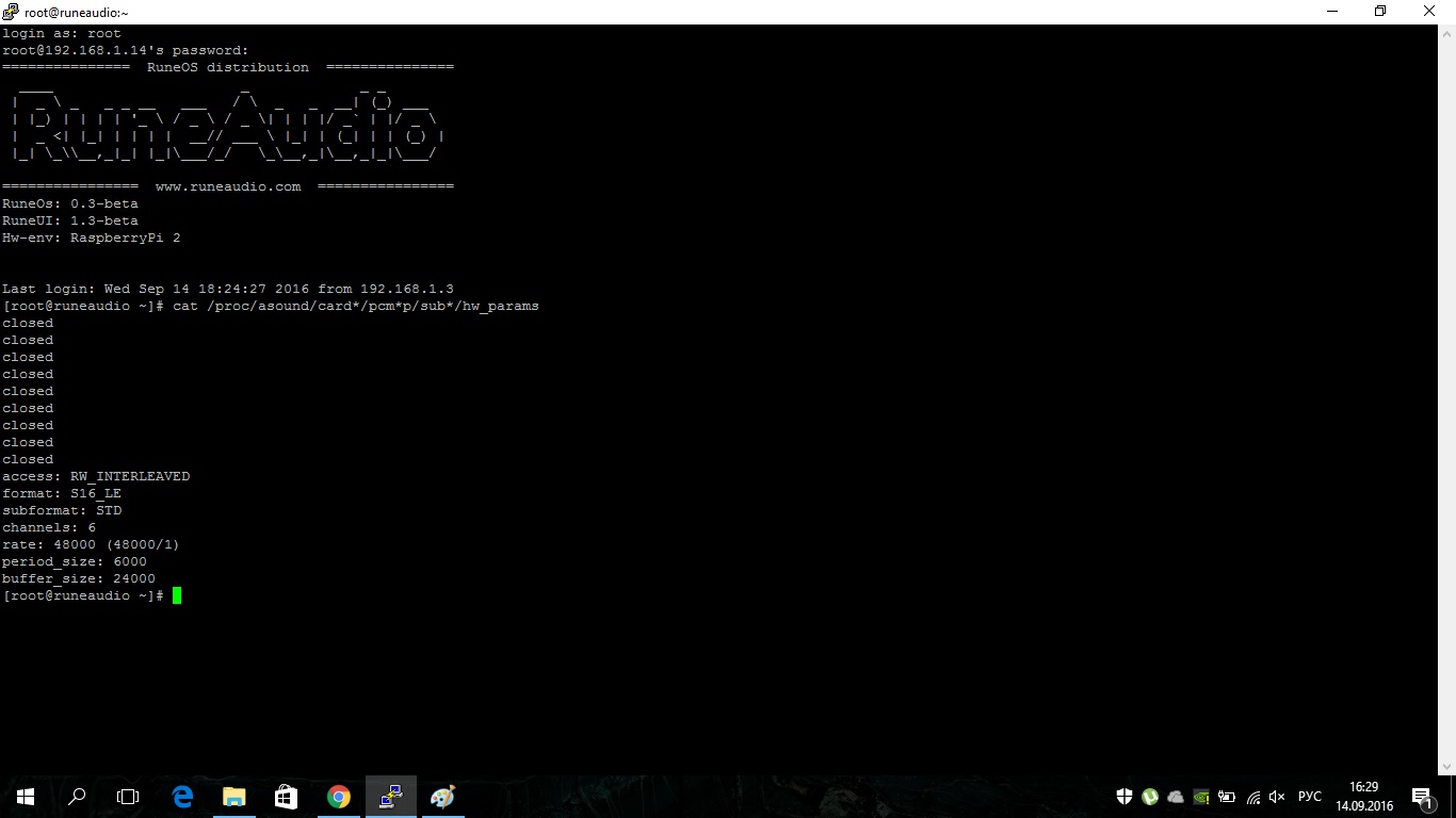

Re: RPi 3 sound is mono!!! from USB.
Postby kreator71 » 14 Sep 2016, 17:32
Save as screenshot
ra ps.jpg (115.61 KiB) Viewed 1964 times

Hi kreator71,
your DAC seems to be a 5+1 channel device, right?
I think mpd uses the wrong channels to play the music.
To find this out you have to check / post your debug data (like mentioned on the post a reply page).

Postby kreator71 » 15 Sep 2016, 14:24
Hi Frank. Thanks for answer.
Only two channels available on AV reciever from USB (i tried 5.1 from LibreElec, not available). At the same time, debugging mode on RuneAudio show all 5 channels.
