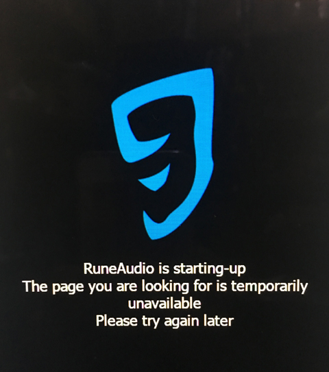

I bought a new PI3B + and used RuneOs: Experimental Beta 0.5 20180903
RuneUI: 0.5B (gearhead) version + SANDISK 8G SD card...
SHA-256 is validated!
Browser operation enters MENU function very slowly. Each function waits for response for at least 3 minutes.
0.5 This version of user feedback is very good, there is a certain degree of stability. It should not be like this!
Please help me find out the reason.

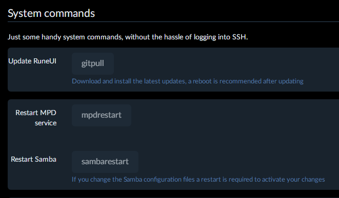

Can't this version be corrected by gitpull from http://runeaudio/dev? I found that gitpull is not available... It seems that you can't update the new revisions you will publish in the future.

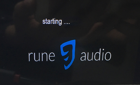

PI3B + HDMI boot appears start.. This picture will continue. Even if the boot has been completed.. The picture will continue.. Is this normal?

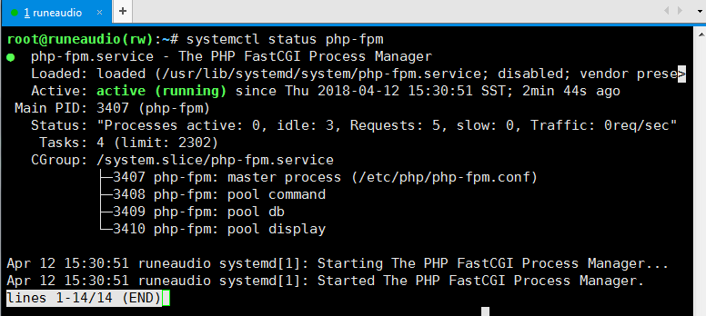

Question C: After booting, the browser will always display Please try again later. No matter how the browser refreshes, it will take about 3 minutes to work properly. Is there any way to speed up the boot?
