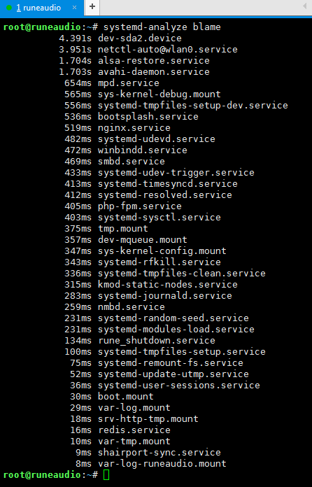

Postby andre_chang » 12 Feb 2019, 08:45
Hi janui:
Modifying the value of config. txt - > boot_delay = 2 < - - - 5-10 is not helpful... Sda1. device is still wrong after restart. Penultimate 1 minute 30 seconds..
PS. These problems will not happen on moode system. He can use usb-hdd to boot normally. There are no errors.
Andre
analyze blame.png (40.08 KiB) Viewed 2056 times

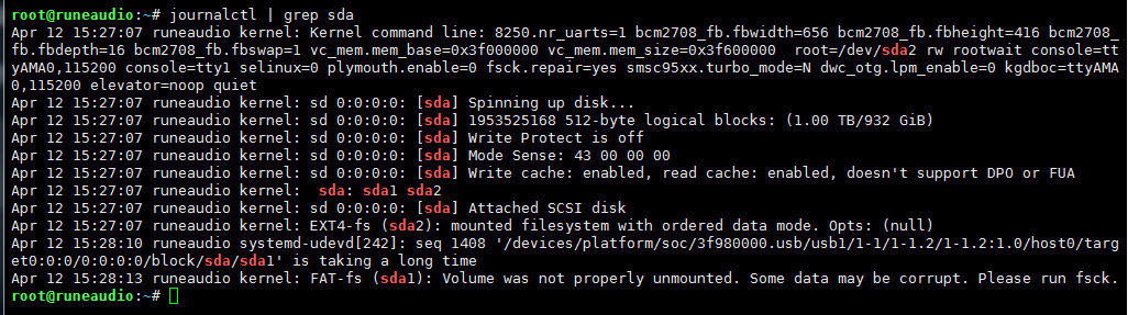

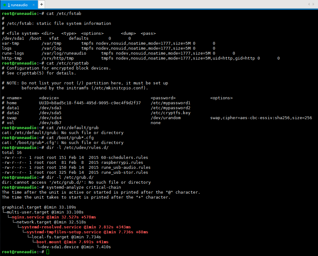

Postby andre_chang » 13 Feb 2019, 16:48
Hi janui:
This is the output you need:
Andre

Postby cmh714 » 13 Feb 2019, 17:17
does vfat = ext4???
