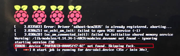

Postby andre_chang » 10 Feb 2019, 11:15
Although it can boot up, Paruuid has an error.

so not to throw any wrinkles in.....and I didnt want to search the thread so sorry if this was potentially addressed.....
I am curious if this is an externally powered USB or if its getting it from the Pi? because I would think it does need to be externally powered AND already powered up and spinning when the pi boots.....
just some random thoughts.....GL!!!

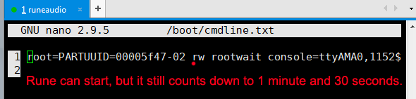

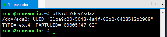

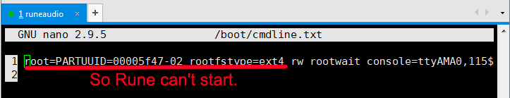

Postby andre_chang » 11 Feb 2019, 18:20
Hi janui:
I have modified cmdline. txt to: / dev / sda2
After restart: A start is running for dev-sda1. device (countdown 1 minute 30 seconds)
Then enter the UI settings. Turn off USB automount and restart!
He still appears A start is running for dev-sda1. device (countdown 1 minute 30 seconds)
Andre
