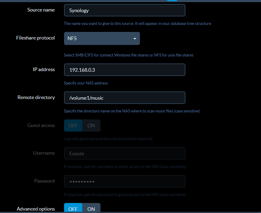

I have got a Nas synology Ds214 play, a dac mydac and a raspberry pi model b+.
On which one, runeaudio is installed.
i can play music from a usb stick without problem.

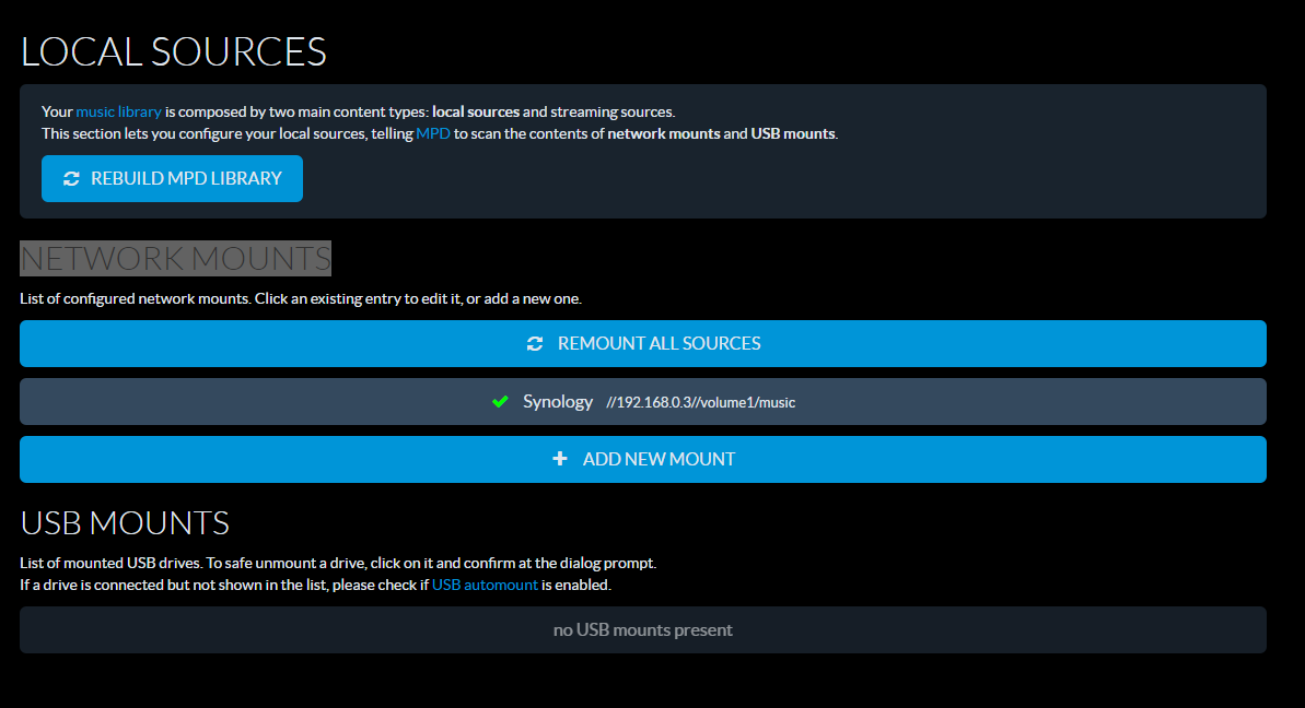

i have made a network mount (in nfs) and it seems to be fine until this point.

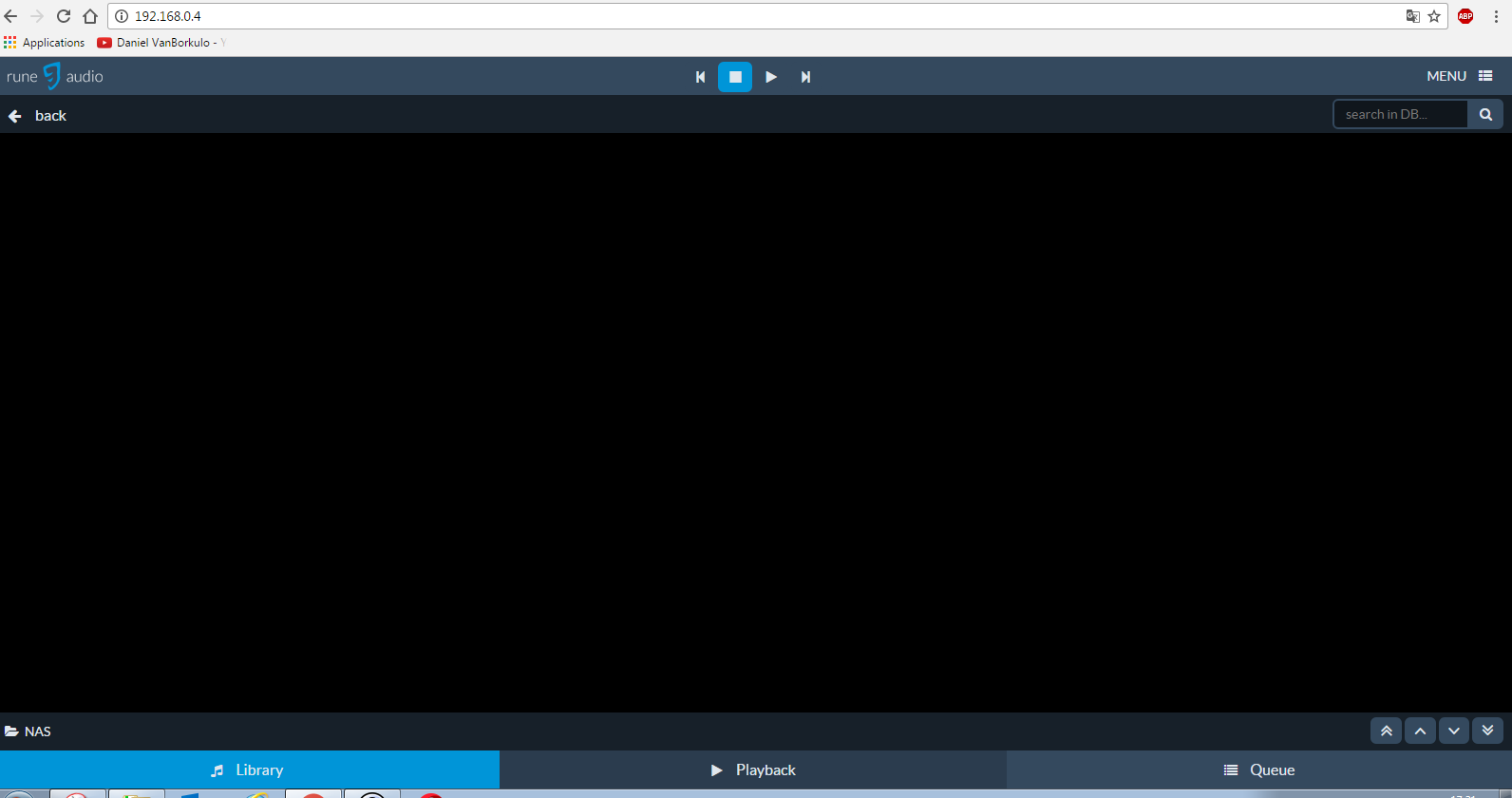

But i have an empty library when i go to library page (as you can see in attachments).
i have try a lot of things (configurations) but nothing changed.
have you got an idea to help me ?
thank you.

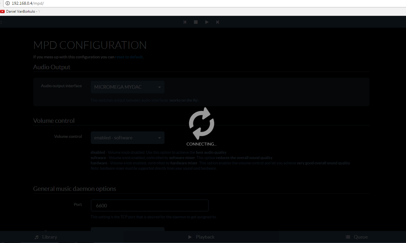

hi hondagx35, thanks for your help.
i have changed the daemon user group but i have a connecting "spinning wheel" loop (as you can see in attachement).
it doesn't stop :s
is it normal ? what can i do to stop it ?

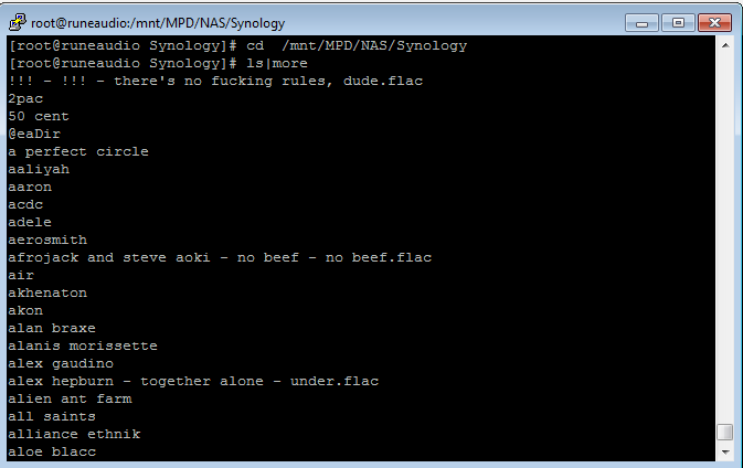

However i have noticed this :
In the repertory /mnt/MPD/NAS/Synology
i can find all my files and repertories with the command "dir" or "ls"
but still nothing in the library (runeaudio webpage)

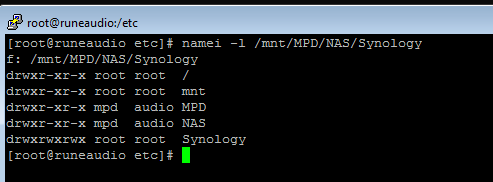

i have also tested :
- usermod -g root mpd (see the first attachment : info1.png)
- remove the line "group "mpd"" in /etc/mpd.conf (see this link )
But nothing work for me :s
i m pretty sure that's certainly nothing, maybe a permision or something like that but what ?
I don't understand why i can retrieve my file like this :
cd /mnt/MPD/NAS/Synology
ls (or dir)
see the second attachment (info2.png)
ls | more
usermod -g root mpd
kolo

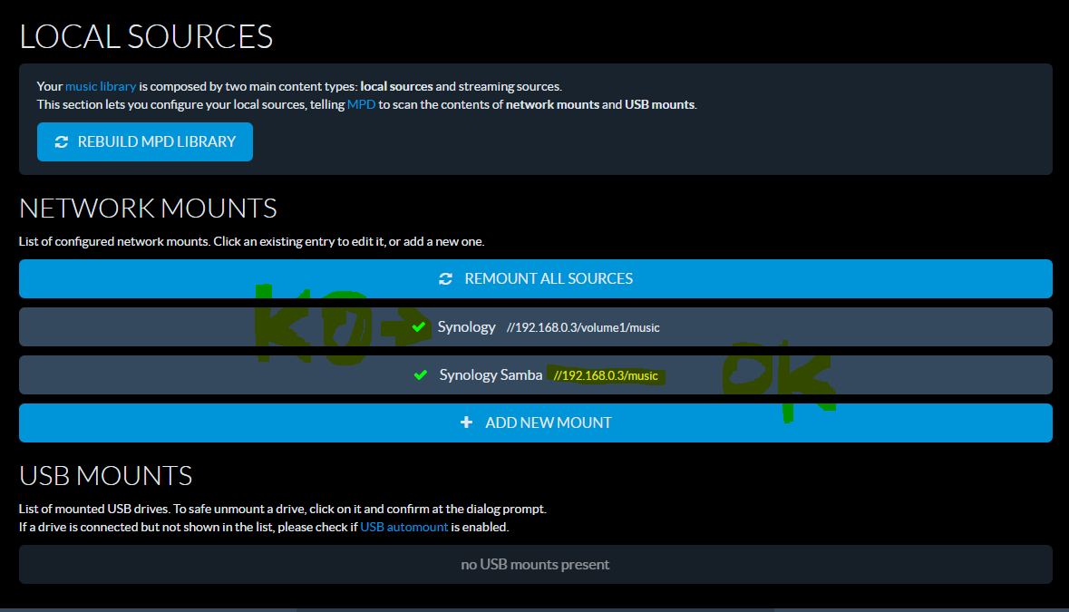

Postby kolo » 05 Dec 2016, 20:17
i have try a samba mount and it s work with samba
But the path is different (see the attachment)
And when i try with the same path in nfs it's doesn't work
i still don't know why.
