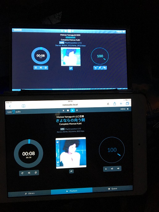

Hi Elvis,
I just do some more test and found that the problem seems just happen when play the song with non english character in the file name. Is it the same for your case?
Frank, thank you for your advice.
Just tried to disable the HDMI output.
MPD audio outputs status: (mpc outputs)
Output 1 (ODROID-HDMI) is disabled
Output 2 (Cayin iDAC-6) is enabled
and disabled DSD
audio_output {
name "Cayin iDAC-6"
type "alsa"
device "hw:1,0"
auto_resample "no"
auto_format "no"
enabled "yes"
But problem cannot be solved.
Anything we can try if the problem just happen on music file with non english filename?
Best Rgds.,
Acml

Just do some more testing.
The problem is related to the file tag, not file name.
The problem happen if either the "tltle" or "artist" including non-english character.
Hope it can help to narrow down the problem and make it easy for your troubleshooting.
Best Rgds.,
Acml

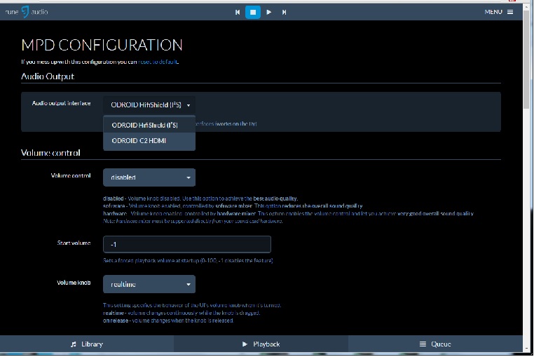

Sorry for provide insufficient information.
Here is the findings and debug info.
1. When I use iPad to control, once select I2S to ODROID HifiShield(I2S),
Funding one: system hanged
I cannot take control with iPad or even I start browser with PC. so I cannot collect debug info.
Funding two: counter showing first song play non-stop, second song on play list will not play
when I use PC to control , it is not the case.
After I setup I2S output option. I can collect debug data
http://pastebin.com/6kp9V6Bz
2. Audio output interface works on the fly not work for Combo384 Amanero
Here is UI debug info when I plug Amanero before ODROID power up
http://pastebin.com/ghjF4Nbm
But when I plug Amanero after power up, interface not works on the fly
Also although ODROIDDAC appear at debug info, item not find at option list
http://pastebin.com/JhR9Ajg3
Furthermore, from debug info, select ODROID Hifishield (I2S) seems weak up 7 pins I2S connector output,
If I can connect it to all I2S supported device, the option name ODROID DAC (I2S) may be better.
Best Regards
Michael
