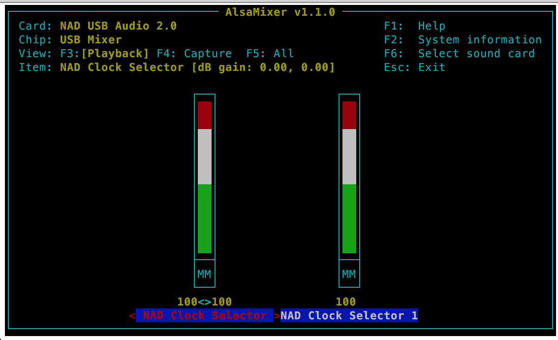

Postby maha0098 » 11 Oct 2016, 07:02
Thank you for the suggestion! I SSH'd in to the Pi, entered alsamixer, found the device via sound card device 1, and can see that the volume is set to 100 for both. I still have no audio even after saving and rebooting the Pi.
I've attached a screenshot if that helps to further troubleshoot the issue?
Screen Shot 2016-10-11 at 12.01.27 AM.png (76.17 KiB) Viewed 2326 times

After I did some more googling, found out that my sound card X1S USB DAC was muted. Using alsmixer, choose the sound card (F6), below the volume control it shows MM, which is muted. I choose the device, then type "m" to unmute it. it changed from MM to 00.
since I have 2 volume control, I need to change both
thank you. my problem solved.
