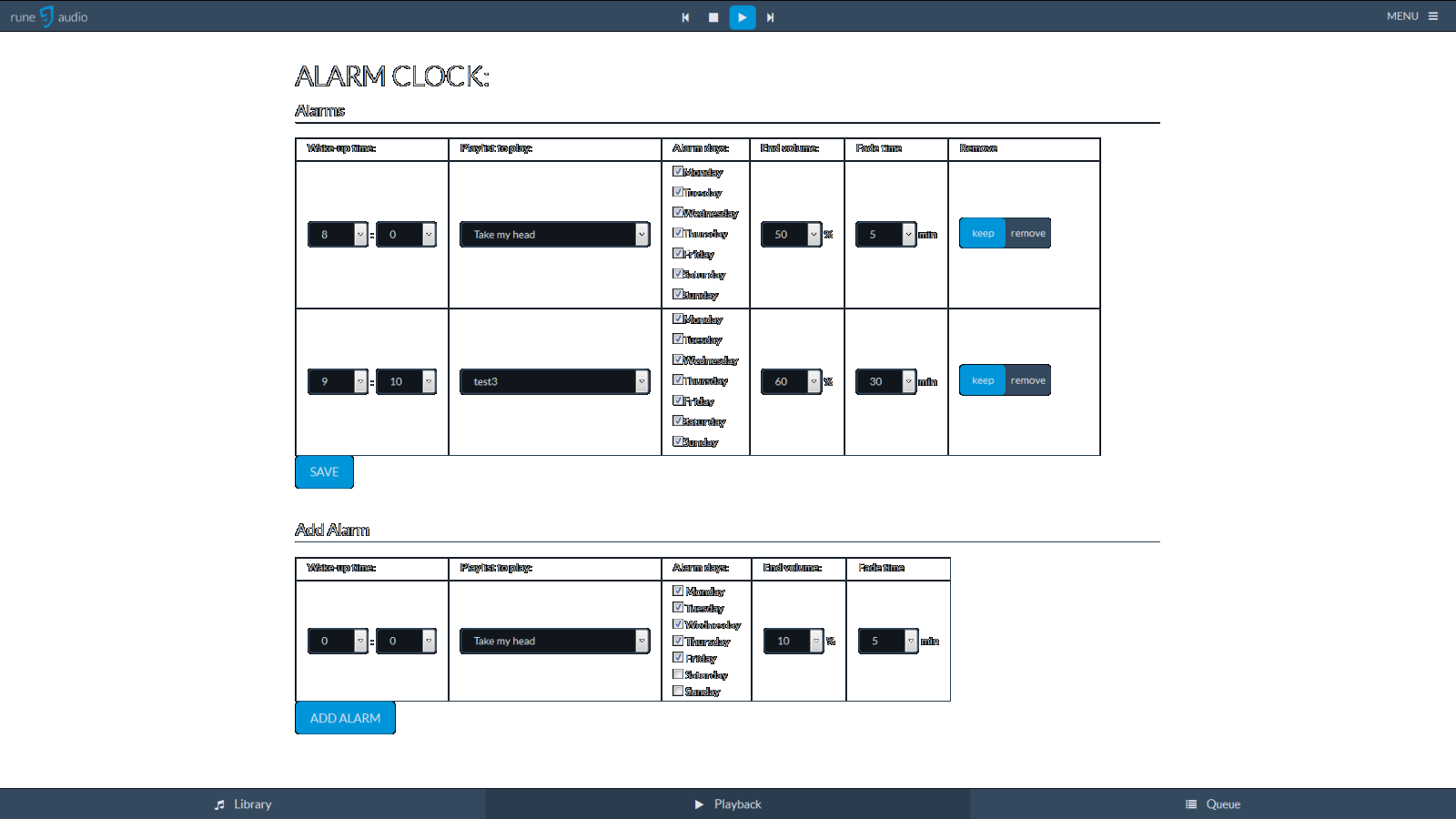

Postby restinpieces » 28 Feb 2016, 22:38
Very nice! I really like this mod.
I tinkered a bit with it and added some more control and the function to add multiple alarms.
Any playlist created in the queue window can be selected as Alarm playlist.
The only problem is I am very bad at styling :( So the look isn't that great and it has some display problems with mobile devices.
If someone is able to add some style to it I would be really happy!
Picture:
Extract the alarm.php file from the zip and replace /var/www/app/templates/alarm.php with it.
alarm.zip
(2.14 KiB) Downloaded 718 times
