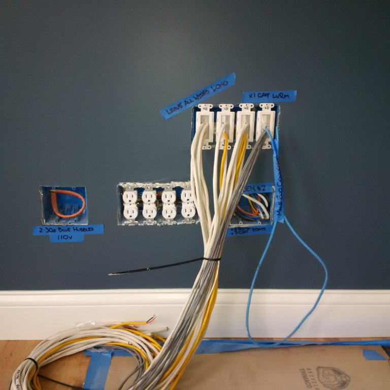

Postby eea123 » 30 Jun 2018, 12:08
I hard-wired a central stereo setup in the den using 14ga speaker cabling to various rooms in the house during construction. I used in-wall speakers with Niles Volume and IR Controls to be able to turn off speakers if needed. This might also be feasible in an existing home if your basement isn't finished. I had the electrician run a dedicated electrical circuit for the amplifiers, the blue Hubble outlets hadn't yet been installed on the left. I also have a Niles IR-6 distribution for controlling older infra-red remotes, that's the thinner grey Belden cabling for it in the mix. I also picked up a Niles "RCA to CAT5 to RCA" converter to bring the living room's TV feed into the den. I have an older B&K REF 50 preamp that doesn't support HDMI, but Niles has a similar HDMI system that you could use.
I only recently added a network player using a Raspberry PI w/ an additional DAC's RCA outs into the preamp. I'll have to say that I now use the network player 50% of the time and a Polk XM tuner 40%. I have a Yamaha 110-disc CD changer and FM tuner also, but those get used less and less since the addition of Rune w/ the PI.
