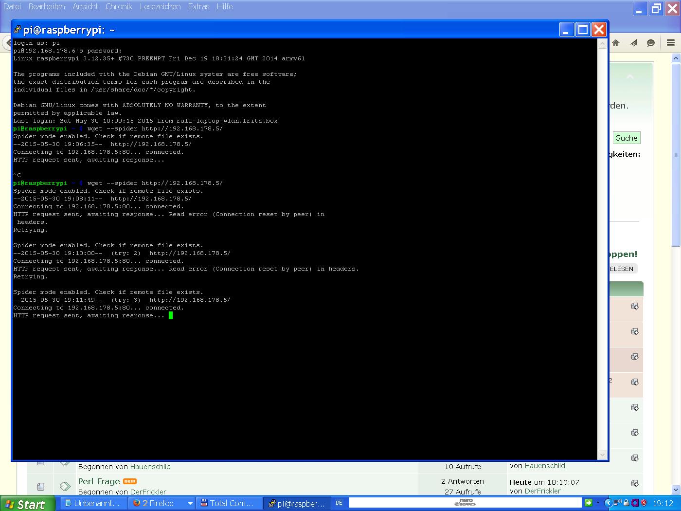

I am trying now to call the http Rune UI every minute
with a cronjob on my homeautomation server (Rasbian / FHEM).
*/1 * * * * wget --spider http://192.168.178.5/
I will report back if this helps...
Ralf
rasti
Posts: 40
Joined: 21 May 2015, 16:27
Re: loosing wifi ?? connection to rune
Postby rasti » 30 May 2015, 18:19
it does not help.
Loosing http connection after ~500 minutes of webradio.
Webradio keeps playing, FTP/Telnet works, just http Rune UI is not accessible.
After that I logged on on the other raspi and entered manually the command
(that's exactly what the one minute cronjob did)
Result see file attached :
it is connected to port 80 but then a read error appears
I even tried to reboot my Wifi Access Point only.
Webradio stops playing and reconnects
ftp/telnet works
http does not work.
Anything I can do now ?
I left it now as is, maybe you can tell me what
I can test now if is stuck. I still can telnet/ftp to Rune Server
and the music is still playing....
If I reboot it will be working again of course....
Any idea ?
Ralf
crron to keep rune UI alive.JPG (168.45 KiB) Viewed 2701 times
