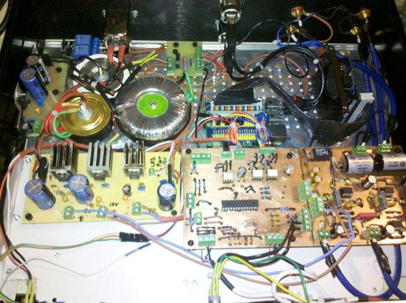

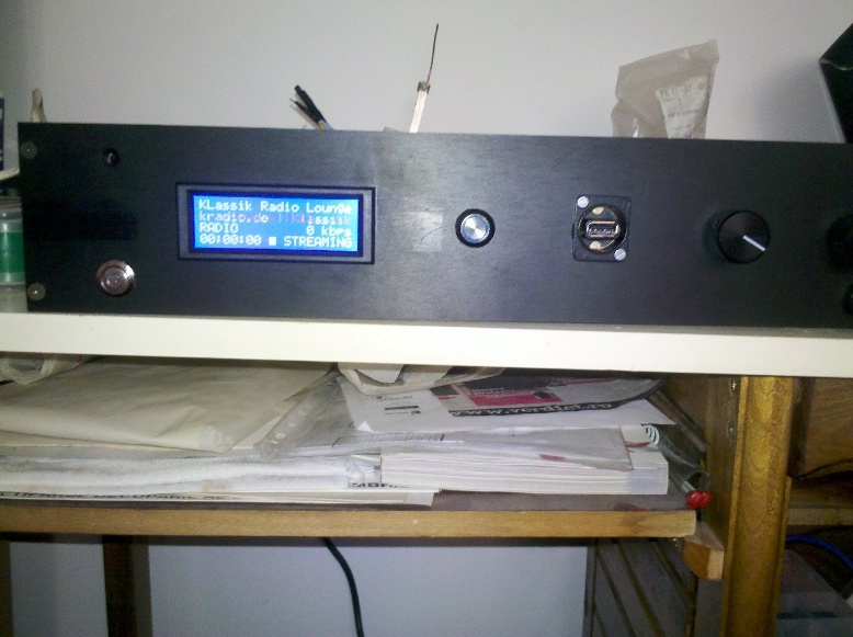

Thank you Rune team for the great job. I also followed s.k.'s method on page 12 and now I have a working RPi + PIFI Digi DAC+ 20 x 4 LCD and buttons. I add one standalone Arduino to control Raspberry , don't use serial communication but opto-coupler to act like buttons and I do this to isolate SBC from the microcontroller and also to change the buttons with rotary encoders . I disable remote control on raspberry and will add a remote for arduino to control the same opto-couplers and finish this with a pass band filter . Please excuse my bad english.
