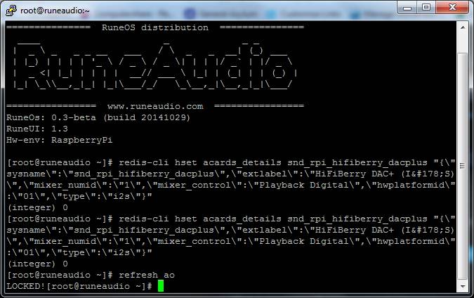

No joy so far.
Step 1. I login in with user: root and password:
After executing your step 2: I see : " (integer) 0"
After executing step 3: I see: " Locked!"
And I can't go to step 4 since I have to use the ip address.

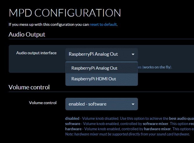

But when I go to ip addres http://192.168.178.27/mpd/ I cannot choose the hifiberry dac+
Kind regards,
Bas
