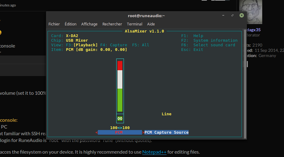

Postby okcoolcoolmins » 30 Dec 2016, 17:46
Is it possible that the volume of the dac isn't 100% by default?
I know the word SSH and when I see it, I run far far away... But I'll try it.
If my computer doesn't fly through the window, I'll let you know. :)
Thank you very much

Postby okcoolcoolmins » 30 Dec 2016, 18:40
Impèc SSH alsamixer
Capture du 2016-12-30 18-03-24.png (72.74 KiB) Viewed 3727 times
