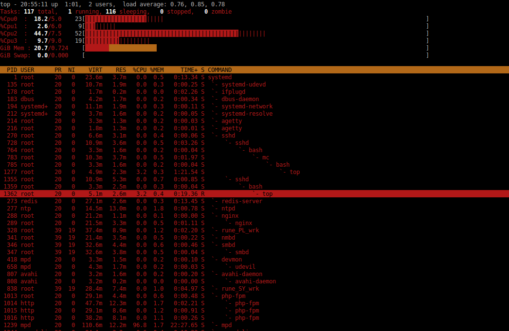

Tests:
.flac, .wv and .wav up to 24 bit, 352.8 kHz are played OK.
top result, when playing 16 bit, 44.1 kHz .wv (CD)
- top_wv_44.1_kHz_16_bit.png (108.06 KiB) Viewed 3983 times

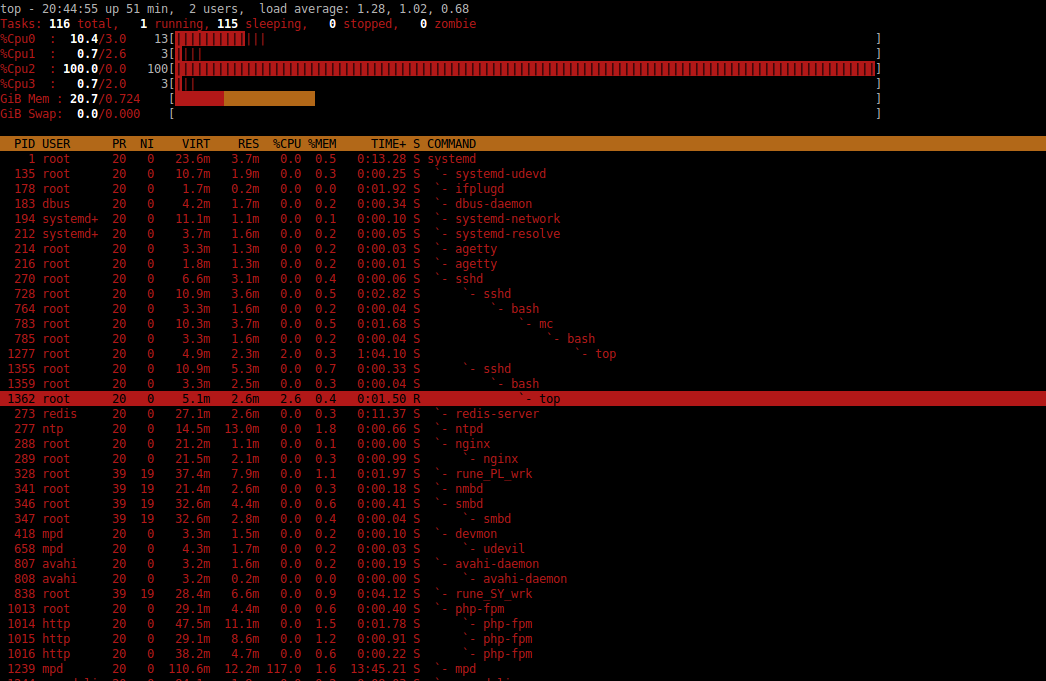

DXD .flac, 353.8 hHz, 10415 kbps is also played, but not fluent.
top result:
- top_dxd_352.8_kHz_10415_kbps.png (108.37 KiB) Viewed 3983 times

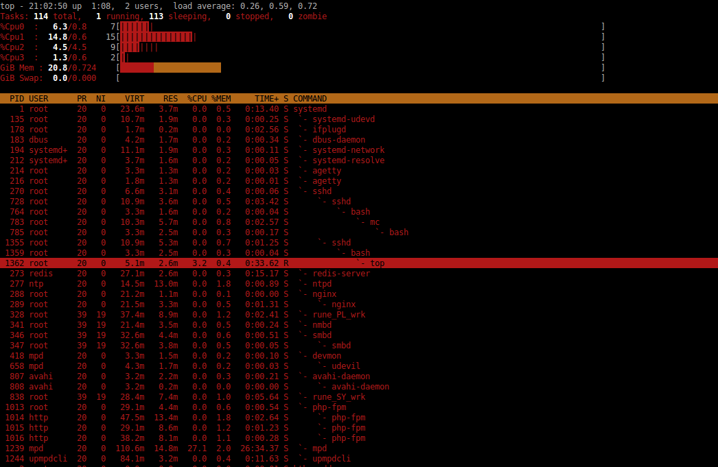

.dff DSD is played locally very bad (a lot of breaks), on slaves some noise:
- top_dsd_352.8_kHz_2822_kbps.png (107.58 KiB) Viewed 3983 times
.mp4
Locally OK.
Slaves - only very bad noise.
