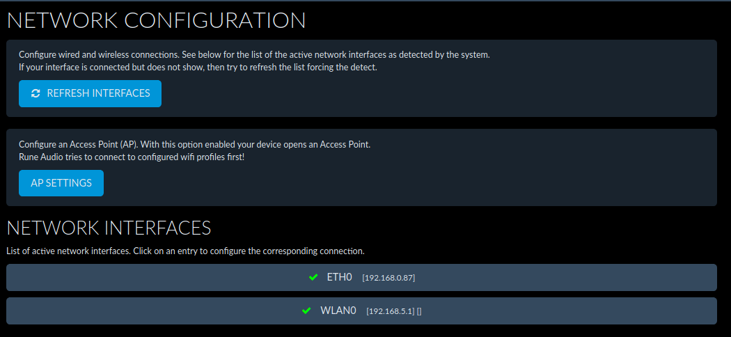

- Screenshot_network-config.png (51.93 KiB) Viewed 2163 times
To answer my own question, "Yes - I think it does !"
I borrowed a router using a more normal 192.168.0.xxx/24 range, AND IT WORKS! The above screenshot shows 1) that I have an connection and I can connect; 2) the WiFi AP is using *MY* network adress range.
So my question becomes : how can I connect RuneAudio to a 192.168.
