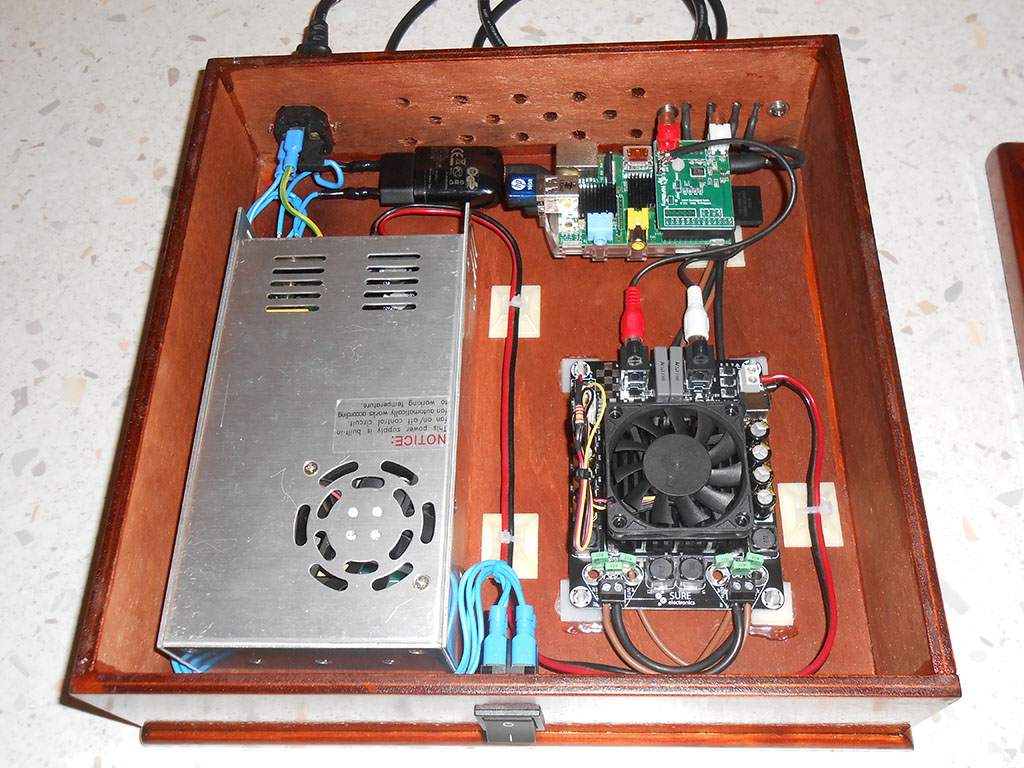

A few days after meeting in person the Rune Audio staff (at their stand in Udine, for the Open Source Day) I decided to give it a try and build - or better to hack together - an autonomous box with the fewest possible connections to the outside world.
It is just an experiment, made recycling what I already had at home. It uses a raspberry Pi version B, an HiFiBerry DAC, a class D Sure amplifier based on the ST508 chip, a 27V 13A switching power supply for the amp and a 5V 1A (actually a phone battery charger) for the Raspberry and the DAC. Network connection is working via WiFi (a TP-Link dongle), mass storage is a single 16GB USB stick.
- DSCN1793.jpg (141.29 KiB) Viewed 4450 times
- DSCN1796.JPG (143.88 KiB) Viewed 4450 times
- DSCN1799.JPG (242.49 KiB) Viewed 4450 times
The output and input capacitors of the amplifier have been changed since the original SMT ones were of poor quality. As soon as I can get a couple of good 2.2uF caps for the input I'll remove the two grey polyester ones I put in a hurry.

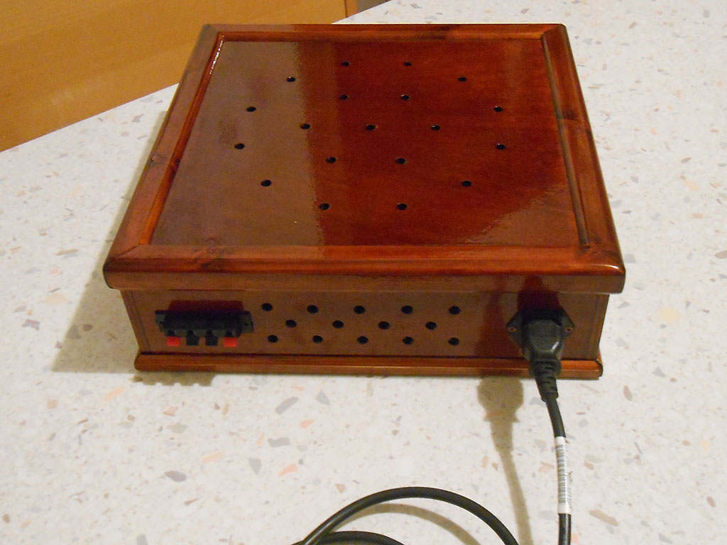

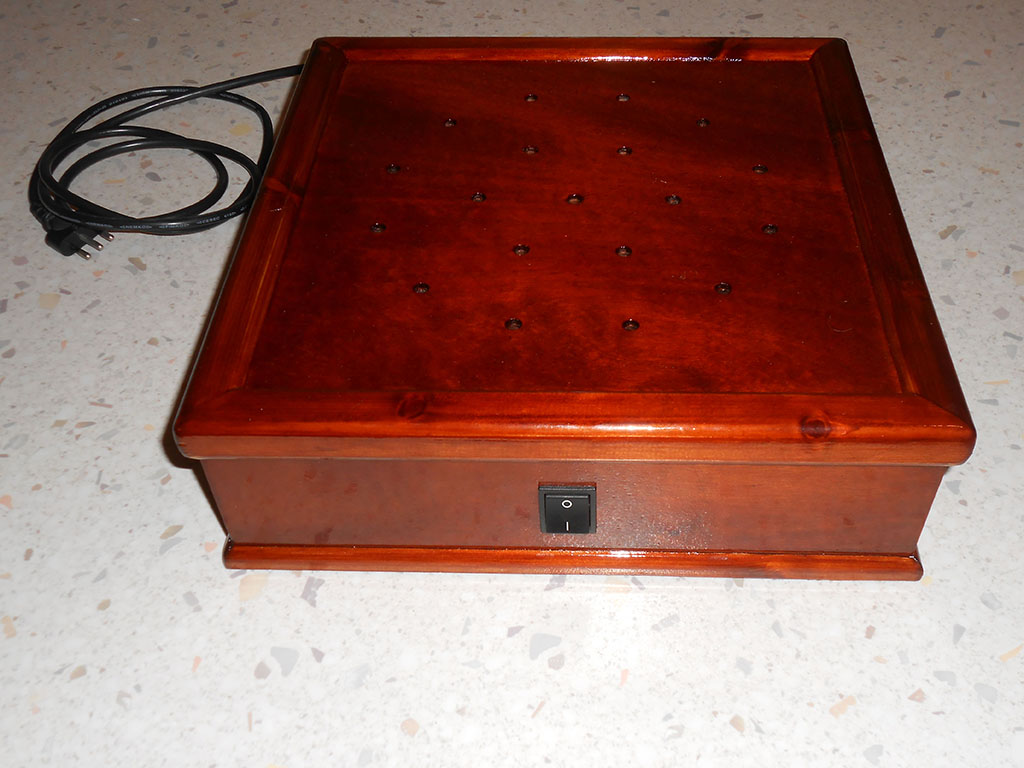

The look may be is a little creepy (my friends told me I built a box for "the hand" of the Addams Family
), but the wood too has been recycled from scrap I had from other projects. Anyway it sounds nice, and everybody gets very curios and amazed to see music coming out from that strange box
Besides improving the input capacitors I'll have to try and add a large electrolytic to the 5V power supply, at times if the song is almost silent it is possible to hear some (very small) noise that looks like it is correlated with the activity of the CPU. May be the phone charger is not stable enough and the current peaks propagate up to the DAC output. We'll see.
One more thing I believe could be useful is an analog pot to manually regulate volume... the RA interface works great (on my Galaxy Note table I found the best browser to be Opera, it almost never hangs) but sometimes you just want to quickly change the volume and waking up the phone or the tablet could be a little slow. Useful but it would break the minimalist look... what do you think?
