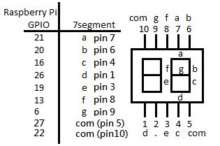

Thanks to his post, his post trigger me to build up the LED volume part. In order to display every volume value from 0 to 100. I change the LEDs to a 2 digi 7 segment LED.
The one I use is common anode. The decimal place was not use. I use python for this. Between Raspberry Pi GPIOs and 2 digi 7 segment LED. I use 220 ohm resistors for com pin (5, 10). Pin 5 control the right 7 segment LED while pin 10 control the left 7 segment LED. Segments ‘a-g’ I use 330 ohm. The aim of those resistors was limit the current from Raspberry Pi’s GPIO to 2 digi 7 segment LED. This method has a disadvantage that the 2 digi 7 segment LED was turn on by quick scanning between right and left digi. So, there will be some flicker but the connection was simple. To distinguish between 0 and 100, I use ‘FF’ to represent 100. Since I am also new to python. So, this python file may be too ‘bulky’. Feel free to make it slim.
In order to run this python file, a service need to be create and enable. For detail how to create service and use this python and start up when boot. Please take Mr. pez’s post for details.
