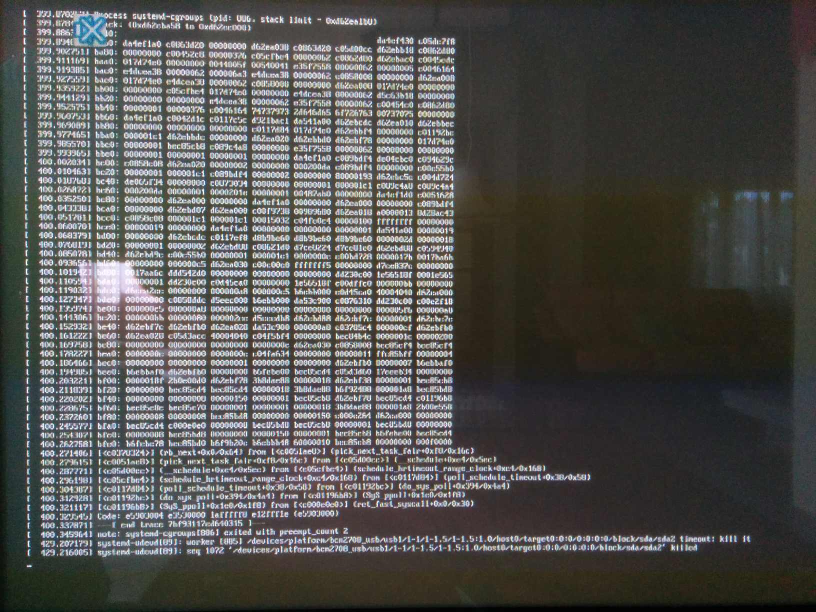

Sometimes I can't turn it off. I click power off in the runeUI and it hangs as the image shows, without turning off.
I don't know if it's corruption on card, but I reflashed it a million times, and after a few days and all the initial settings this reappears.
Raspberry B+ and IQaudio pidac+.
I'm using a usb 2.5 hdd, safe mode gpio=4 and max usb current=1.
All running on a 2.1 amp wall adapter, good usb cable tested up to 2amp.
Power usage should be well under the 2 amps.
I don't have this problem on volumio or other music "distro", so I'm not sure it's related to power supply.
This on 0.3beta. Don't know what's causing it.
Also it's headless setup, so when this shows I can't ssh anymore to take logs...
And there aren't logs on sd card after.
- runeshutdowncrash.jpg (238.07 KiB) Viewed 2284 times
