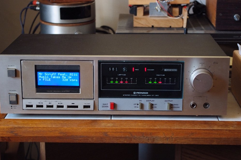

Ever since I got this old (non-working) tape deck, I had an idea of turning it into a Rune Audio music center, complete with the LCD AND working Vu meters.
After quite a long time and several setbacks, it's finally finished.
The buttons in the front turn the VU meters and LCD on and off, and there's also a (red) shutdown button.
When the RasPi has shut down completely, the LCD and one of the red LEDs turn off, so you know it's safe to "pull the plug" - i.e. turn the whole thing off using the original "power" button. There's also an IR remote, plus all the usual stuff....
I'm quite pleased how it turned out
