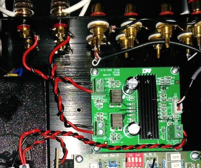

To avoid wiring mistakes, always use red for positive and black for negative. Twisting the wires will give sufficient shielding, see this picture:
- IMG_20140930_1853131.jpeg (201.52 KiB) Viewed 3596 times
