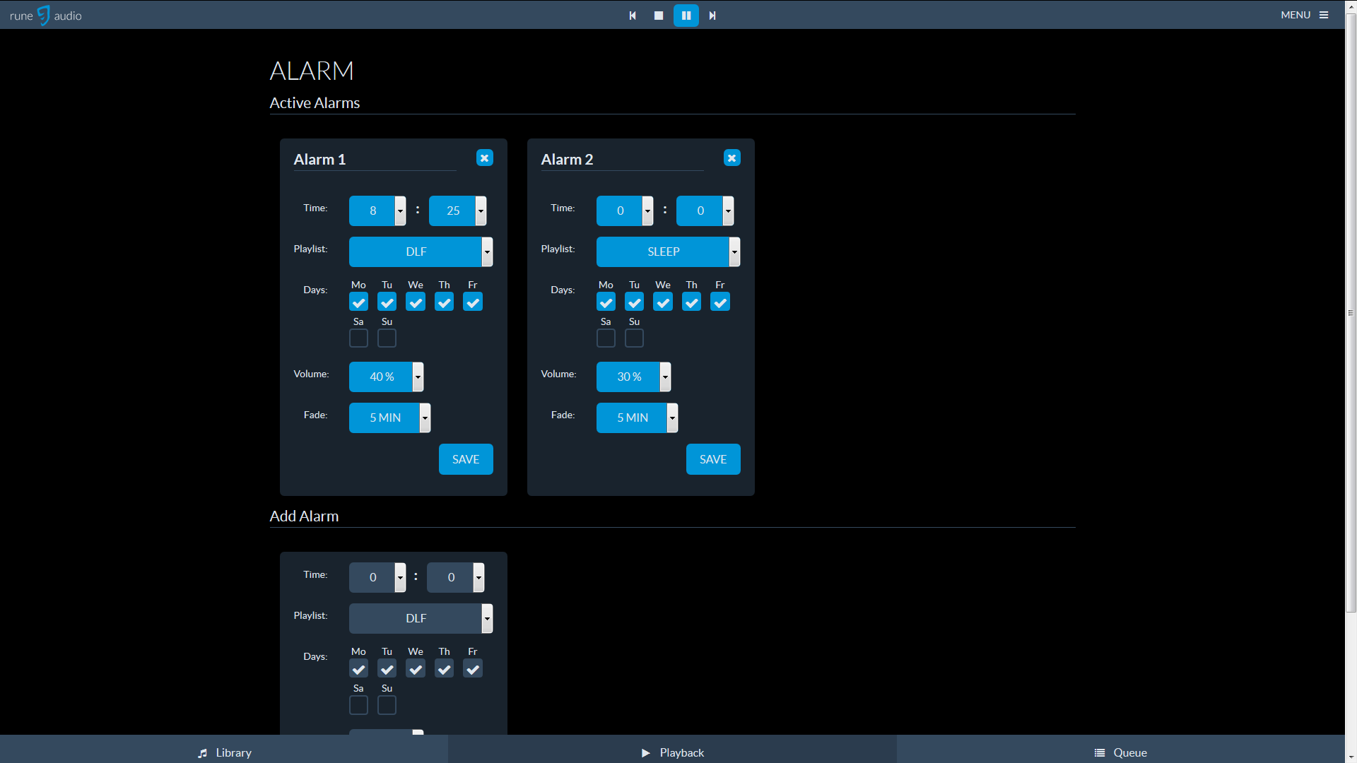

Alarm Features:
- Multiple alarms
- Set time, playlist, day of the week, volume and fade time
- Changing the Volume during fade in stops fading
- Timeout after 1h playing without interaction during fade in

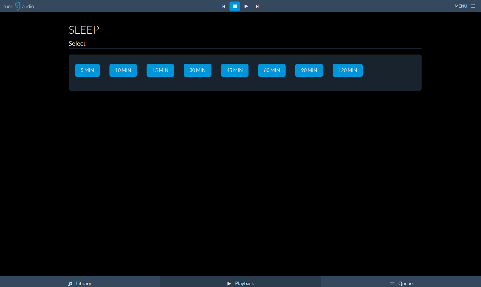

Sleep Features:
- Select the after run time
- Change the volume as you like, the new fade parameters are calculated on the fly
