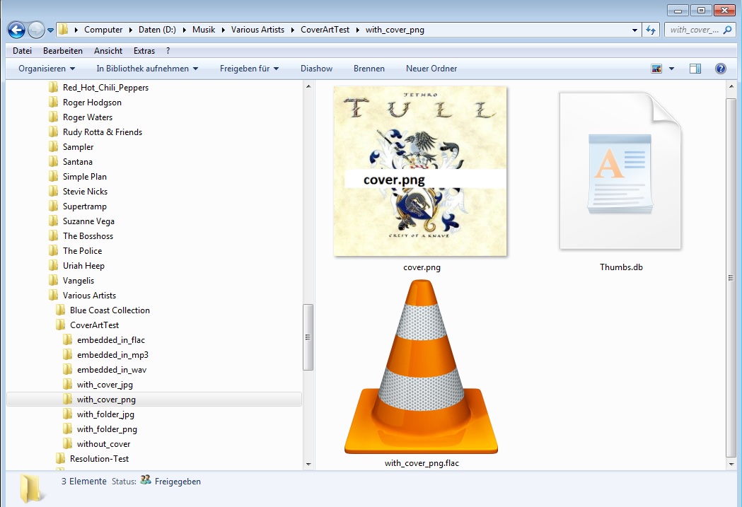

Please check your files for embedded cover art.
The file search (cover.jpg) is case sensitive, maybe this is your issue.
I did some tests on my RP3 and all works like it should.
The same song with all possible cover locations.
- cover-test.jpg (152.21 KiB) Viewed 2568 times
I am very interested in why it doesn't work for you.
