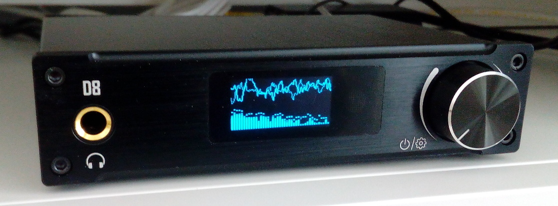

I've got an Alientek D8 with XMOS USB chip because its features almost perfectly fit my needs.
- alientek-d8.jpg (187.25 KiB) Viewed 12688 times
