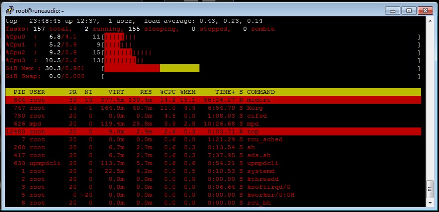

- playing-24-192.jpg (122.43 KiB) Viewed 1790 times
Here you can see the processor load while playing a 24bit 192kHz file.
This is with the local browser activated (displaying Rune UI on a 7" TFT).
This should be an easy task for your device.
