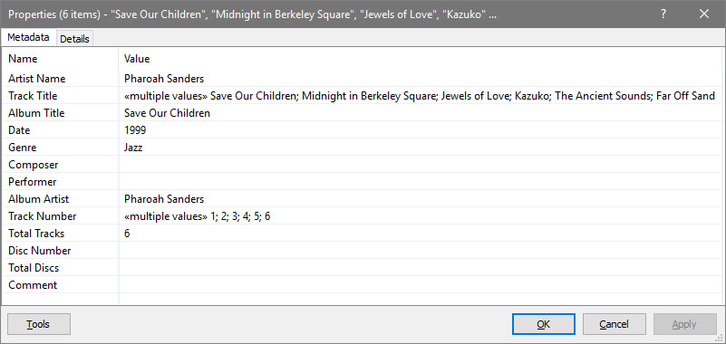

The ID3 tags of the flac-files are:
- tags.jpg (69.04 KiB) Viewed 1826 times

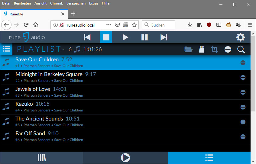

If I add "Jazz/Sanders, Pharoah/Save Our Children" in the library view the new playlist looks like:
- playlist.jpg (106.32 KiB) Viewed 1826 times

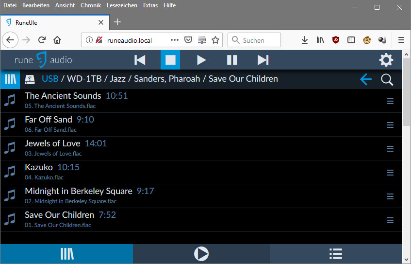

which is consistent with the directory listing above. But if I click in the library view on the directory "Sanders, Pharoah/Save Our Children" the contents look like:
- library.jpg (98.52 KiB) Viewed 1826 times
You see that the contents of "Sanders, Pharoah/Save Our Children" are sorted according track numbers in the playlist, and alphabetically according title names in the library.
