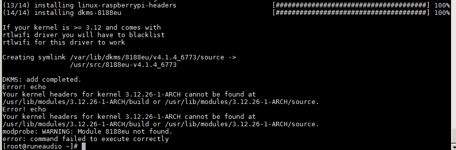

What I have:
-Rpi 1
- Wifi donge 725n
- RuneAudio - last nightly release.
- RuneOS - out-of-box without any update, just fresh os from iso.

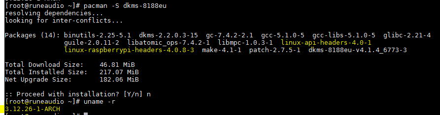

I can't connect with my Hidden secure (wpa2) wifi network. Default driver didn't want to work
I want to 'install' those drivers in the same way but I can't becouse in repo my pacman didn't see linux-headers for 3.12.25-1-Arch kernel.
- repo.PNG (16.51 KiB) Viewed 3056 times
Even if I try to install all what they want, still get error
- repo2.PNG (22.33 KiB) Viewed 3056 times
Im trying to resolve it since 2 day but without success.
Please help
