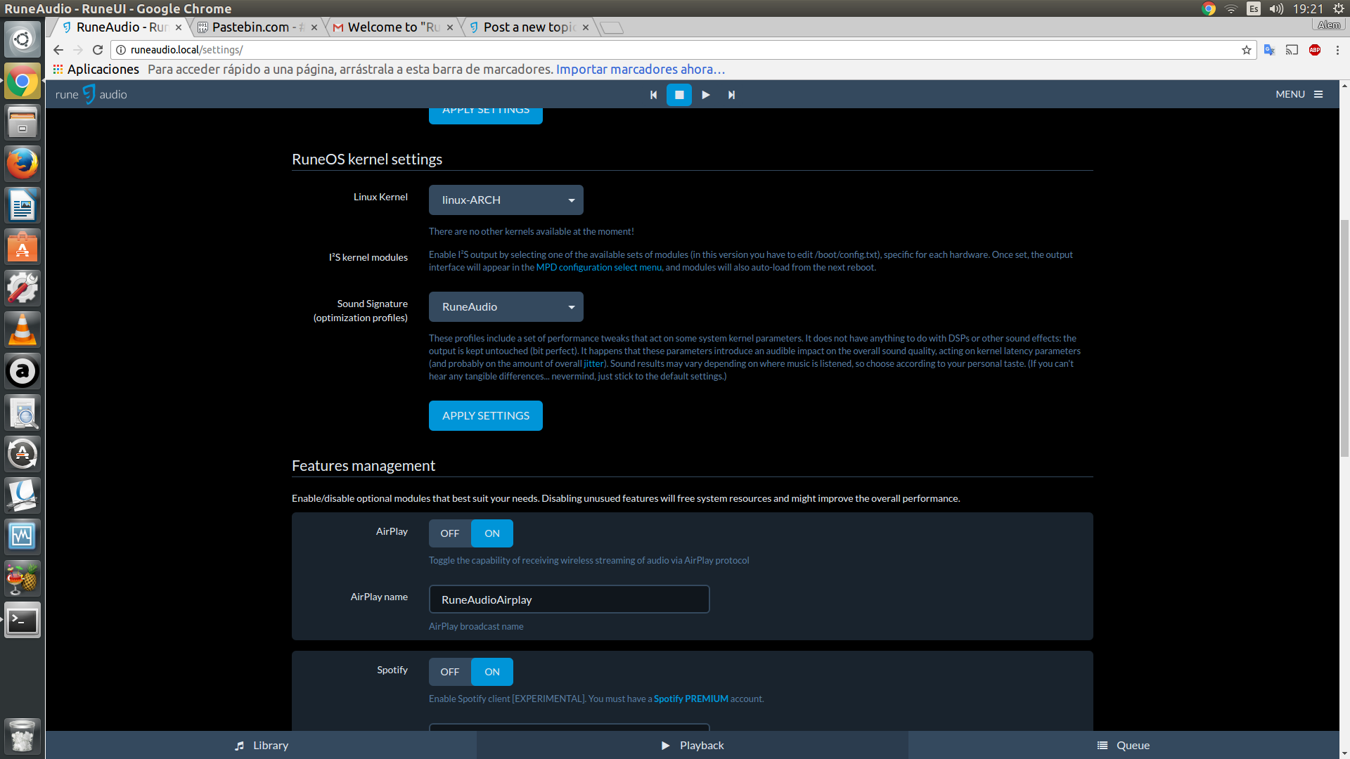

Some days ago, I decided to get a Spotify premium trial and check it with Runeaudio. I got some pops and swapping in the channels while playing only in the Spotify option.
So I updated the kernel via SSH as described here and gitpull also. But now I can`t find my DAC+ and even I tried these settings:
- Un-comment Hifiberry DAC+ in config.txt like the first time I installed Rune. Then sync ,then reboot.
- Checking settings for I2S kernel devices (no list displayed).
- MPD audio output says "Nothing Selected"
- Alsa only detects onboard audio and hdmi. If I disable in config.txt, it doesn't detect any card.
I tried every possible option described on some posts.
This is the debug info
http://pastebin.com/pjJGdkXR
And a snapshot of the settings. Is that ARCH kernel the correct one
Thank you!
