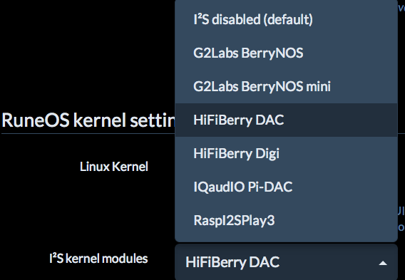

To achieve good results with Raspberry Pi sound-wise, you will also need a DAC. USB DACs are not a good match for the Raspberry Pi. If you are planning to use RuneAudio the same way as you're using your Western Digital, with optical out, I would recommend that you take a look at the HifiBerry Digi DAC. It's a DAC that is tailor made for the Raspberry Pi, that performs great for all files up to 24bit/192kHz.
If you don't need digital out, the HifiBerry DAC or IQ-Audio's Pi-DAC seem to be among the most popular choices. Again, for all formats up to 24bit/192kHz. The Pi-DAC would seem to have the best specs, at least on paper, and it includes a hardware volume control. They have different features though. I use the HifiBerry because it gives me an easy way to add an external power supply, and it sounds really great.
- Screen Shot 2014-09-10 at 00.55.48.png (35.78 KiB) Viewed 4123 times
