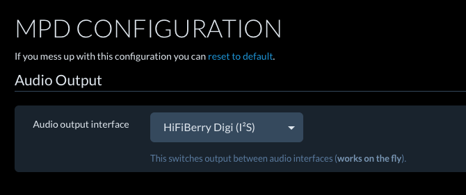

I believe I have everything configured as suggested but my Digi+ Pro is not playing music [EDIT: I do not get a digital lock from the Digi+ Pro to my Schiit Bifrost 4490 DAC on Coax] (flashing red LED on RPi3 Board). Any suggestions on what I am missing would be appreciated. Please let me know if you need any other info. Thanks!
Info:
1) Digi + Pro works fine in Moode Audio
2) Using RPi3
3) Runeaudio version - release version: 0.4 (build: beta-20160313)
4) Linux version 4.4.36-1-ARCH (builduser@leming) (gcc version 6.2.1 20160830 (GCC) ) #1 SMP Fri Dec 2 19:23:34 MST 2016
5) Output from aplay -l:
**** List of PLAYBACK Hardware Devices ****
card 0: sndrpihifiberry [snd_rpi_hifiberry_digi], device 0: HiFiBerry Digi+ Pro HiFi wm8804-spdif-0 []
Subdevices: 1/1
Subdevice #0: subdevice #0
6) boot/config.text section:
#dtparam=i2c_arm=on
#dtparam=i2c_vc=on
#dtparam=i2s=on
#dtparam=spi=on
#dtparam=act_led_trigger=mmc
#dtparam=audio=on
#dtparam=uart1=off
#dtoverlay=pi3-disable-bt-overlay
# Uncomment one of these lines to enable an audio interface
#dtoverlay=hifiberry-dac
#dtoverlay=hifiberry-dacplus
#dtoverlay=hifiberry-digi
#dtoverlay=hifiberry-amp
#dtoverlay=iqaudio-dac
#dtoverlay=iqaudio-dacplus
7) Screenshot (attached) of MPD Configuration > Audio Output page in UI
- Screen Shot 2017-01-14 at 12.30.57 PM.png (31.64 KiB) Viewed 3018 times
- debug.txt.zip
- (16.08 KiB) Downloaded 617 times
