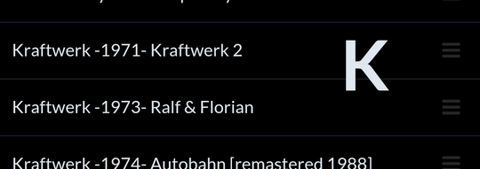

mod: big letter indicates position in one large library folder (of your choice)
One way to make scrolling a large folder of albums easier is to show the first letter of the folder currently near the middle of the screen in a big font. In addition to the regular list the user sees a big A and, as he scrolls down, B C D ... That helps you stop at the right place when scrolling a long way quickly. This mod does just that.
- 1.png (23.12 KiB) Viewed 4670 times
