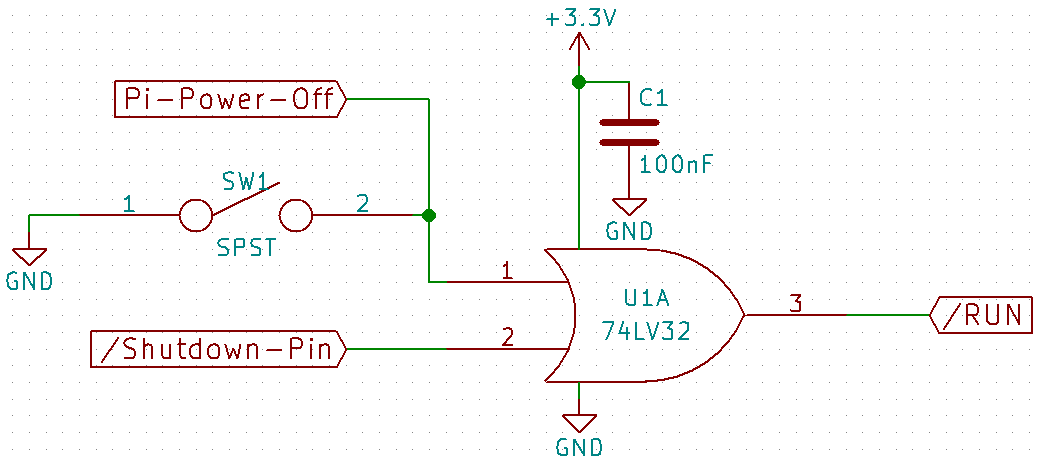

Concerning the RUN-Pin. If you are familir with a solderin iron, you could use an OR-gate (something like an
74LV32) to wire the shutdown-pin and the toggle button together:
- OR.png (9.76 KiB) Viewed 4601 times
Pi-Power-off: Input signal for the raspberry to initiate the shutdown
Shutdown-Pin: The pin, which is held high by the raspberry/external circuit
RUN: The Reset signal
With this, the RUN pin will only be pulled low, if both inputs are low, else it'll stay high.
