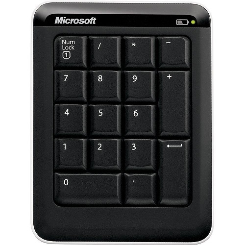

Guide: use a numpad (usb or wireless) for basic RuneAudio controls like play/pause, volume, next/previous track and to load a few favorite playlists.
Numpads are inexpensive and small and convenient as a quick control panel in addition to the regular web interface.
This might also be easier for some to set up compared to adding a hardware knob to the Rune device. There are also wireless versions (with a USB dongle and long battery life) which you can place anywhere you want. You can cover the button labels with new printed labels or some plastic tape with labels drawn with a marker.
- 1.jpg (73.84 KiB) Viewed 10763 times
