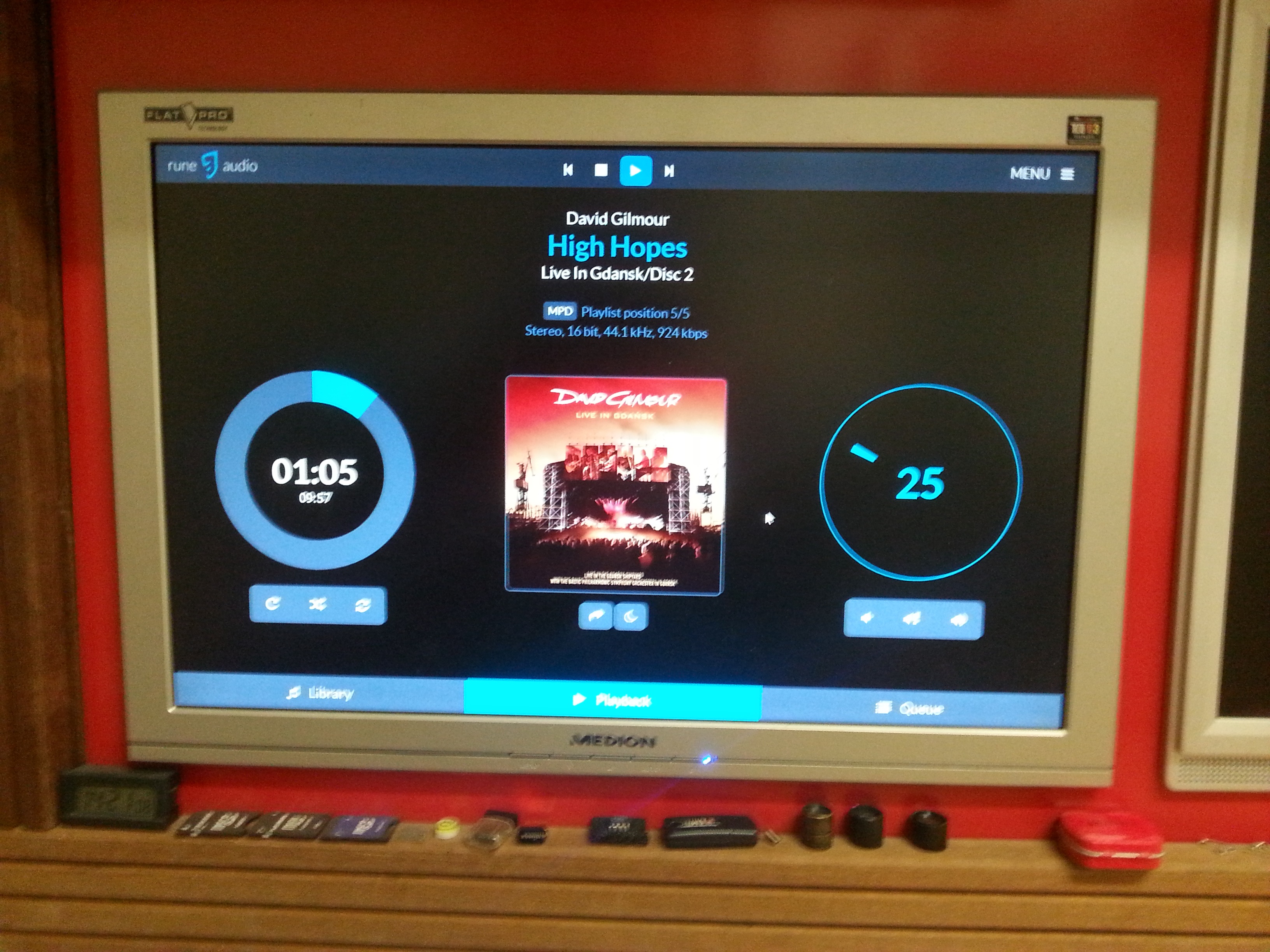

2. Within midori, is it possible to enlarge the cover art picture and also enlarge the font of artist/song/album? There is a lot of "unused" space on the screen and I won't use the TV to adjust setting on other pages of the RuneUI. I will use my PC or phone to do that.
This is one of the great features midori offers.
You can tweak the local appearance by editing the file /root/.local/share/midori/styles/local-styles.css.

But i think it would be better to get the overall scaling right.

and experiment with "zoom-level=0.775678"
You have to restart after each change.
Easier is it to connect a keyboard to your Pi and modify the zoom factor with STRG+ and STRG-.
The zoom-level will be saved automatically in /root/.config/midori/config.
- local-browser.jpg (1.9 MiB) Viewed 2599 times
