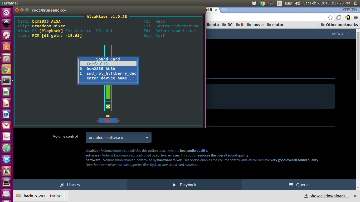

just figured what you might mean with the alsamixer part.
ssh into the pi. -> alsamixer and than i saw this
- Screenshot from 2016-02-06 15-23-03.png (150.36 KiB) Viewed 4090 times
figure changing the card would be an option.. so
- Screenshot from 2016-02-06 15-27-28.png (160.38 KiB) Viewed 4090 times

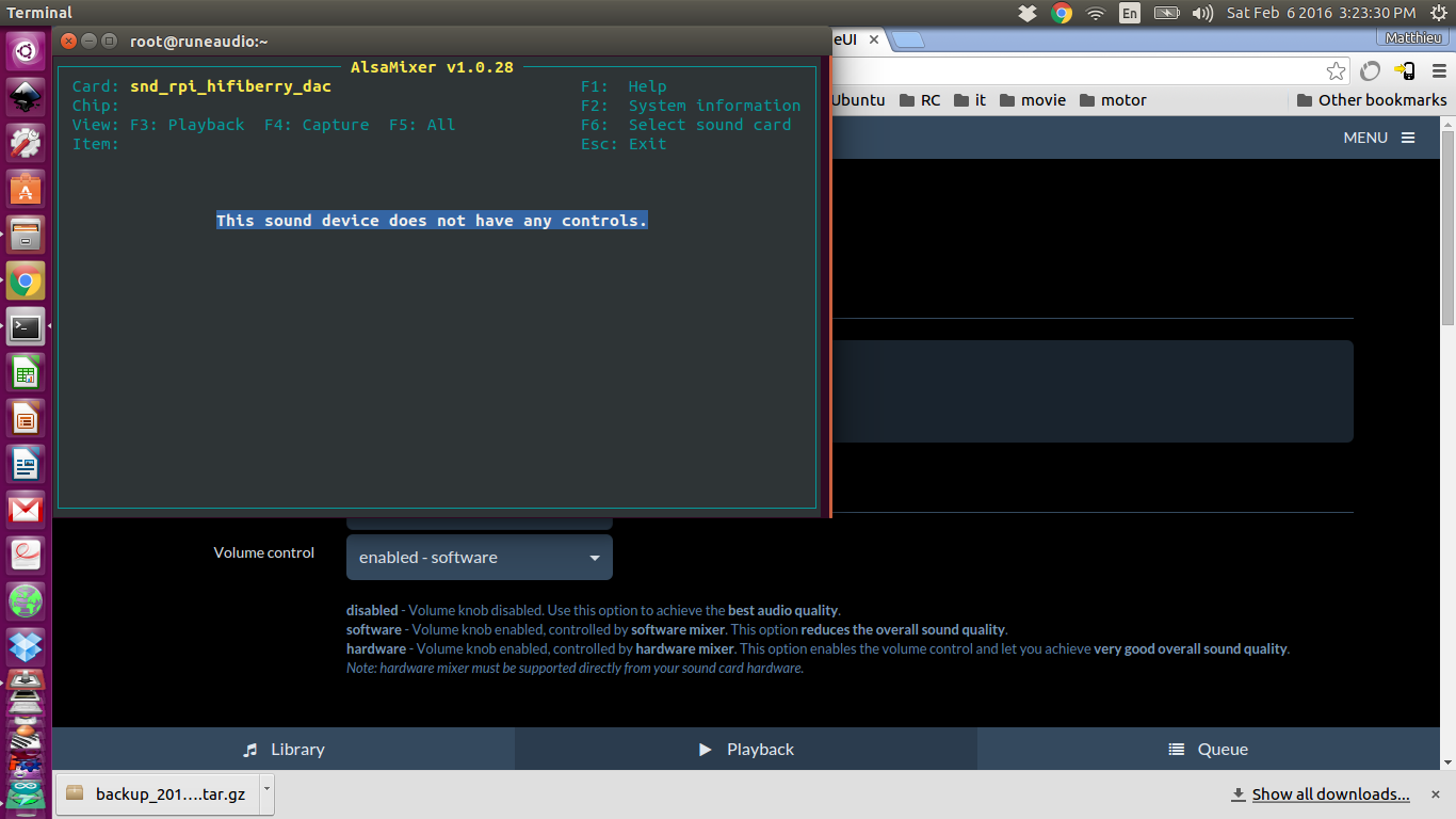

selected the hifiberry:
- Screenshot from 2016-02-06 15-23-30.png (151.24 KiB) Viewed 4090 times
which would be oke, because the intend is to regulated via the z10
but once i exit. and enter again it is back into the alsamixer.
is this the problem? a problem, but not the problem, or is that no issue?
