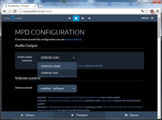

Under Audio output interface of MPD configuration, you cannot chance the default output interface – ODROID HDMI.
- ODROID-DAC.jpg (71.94 KiB) Viewed 3179 times

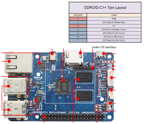

- ODROID-C1Plus.jpg (219.85 KiB) Viewed 3179 times
