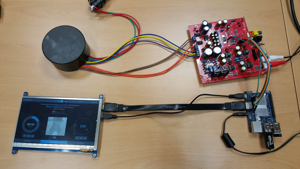

I bought a relatively cheap PCM1794 DAC board at $50 from China Ali-express
and connected to the C1+ via direct connection of I2S bus.
I used a toroidal transformer as a power supply like below picture. The transformer is around $30 in Korea local market.
It works greatly with very high dynamic range (+125dB) and good frequency response.
But the SNR(Signal to Noise Ratio) and THD+N measurement values are worse than the official HiFi-Shield.
It shows around 100dB of SNR while the HiFi-Shield gives over 110dB.
- s_20151221_170113.jpg (87.87 KiB) Viewed 3949 times
I will upgrade the normal voltage regulators to ultra-low-noise version with some nice capacitors when I have time and money for better sound quality.
