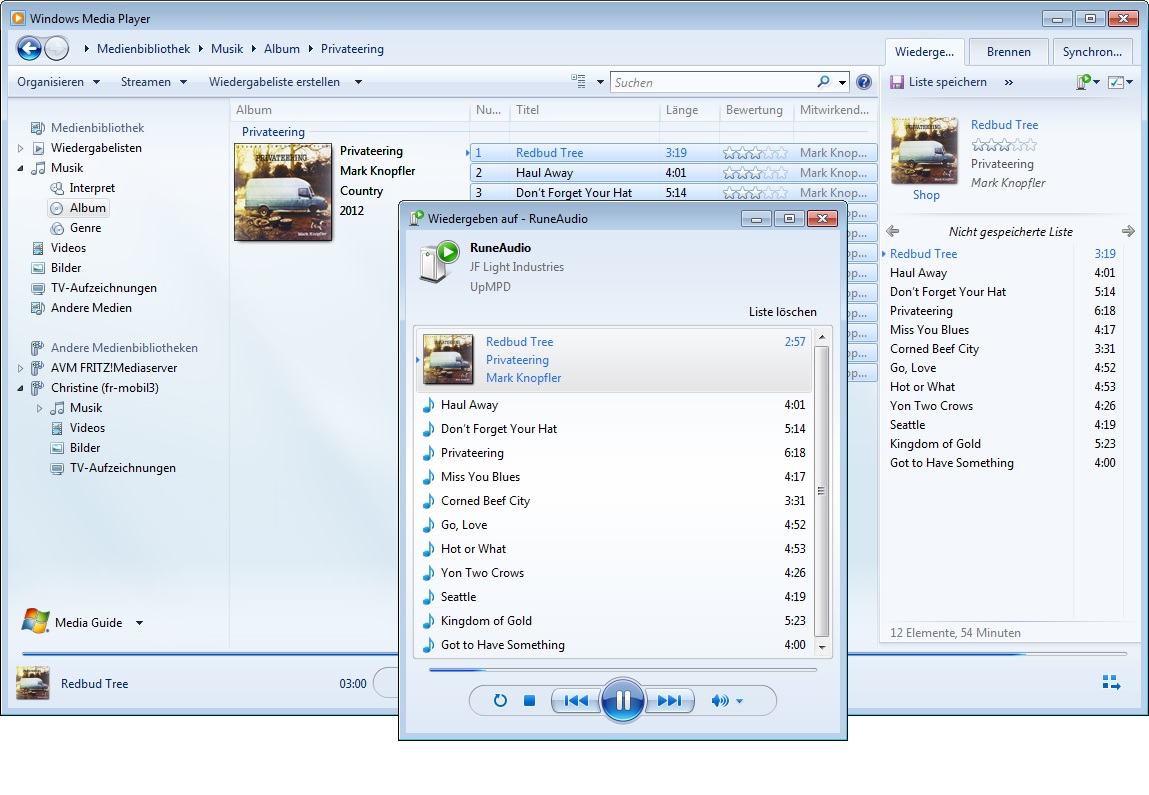

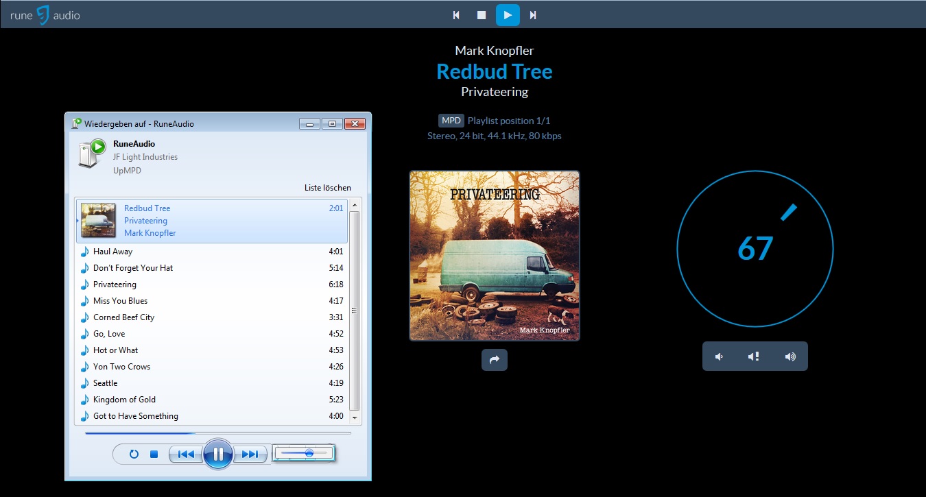

Hi ,
RuneAudio supports UPNP/DLNA out of the box.
So it's no problem to stream content from your PC to your RaspberryPi.
One possibility is to use Windows Media Player.
How to configure this on your Windows PC see for example
here.
Your RuneAudio device doesn't need any configuration at all.
