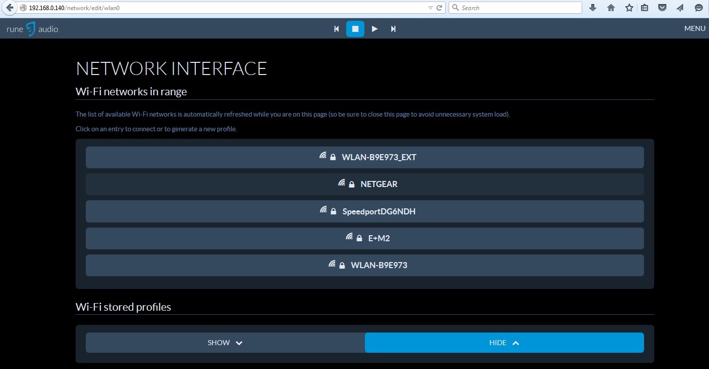

- navigated to menu->network
- NW1.jpg (105.63 KiB) Viewed 2160 times
- after the scan has finished i clicked on the SSID i want connect to

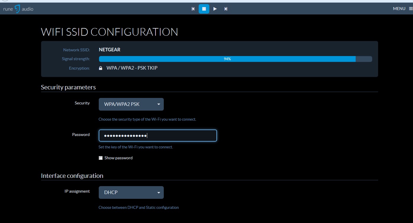

- NW2.jpg (127.07 KiB) Viewed 2160 times
- entered all necessary data

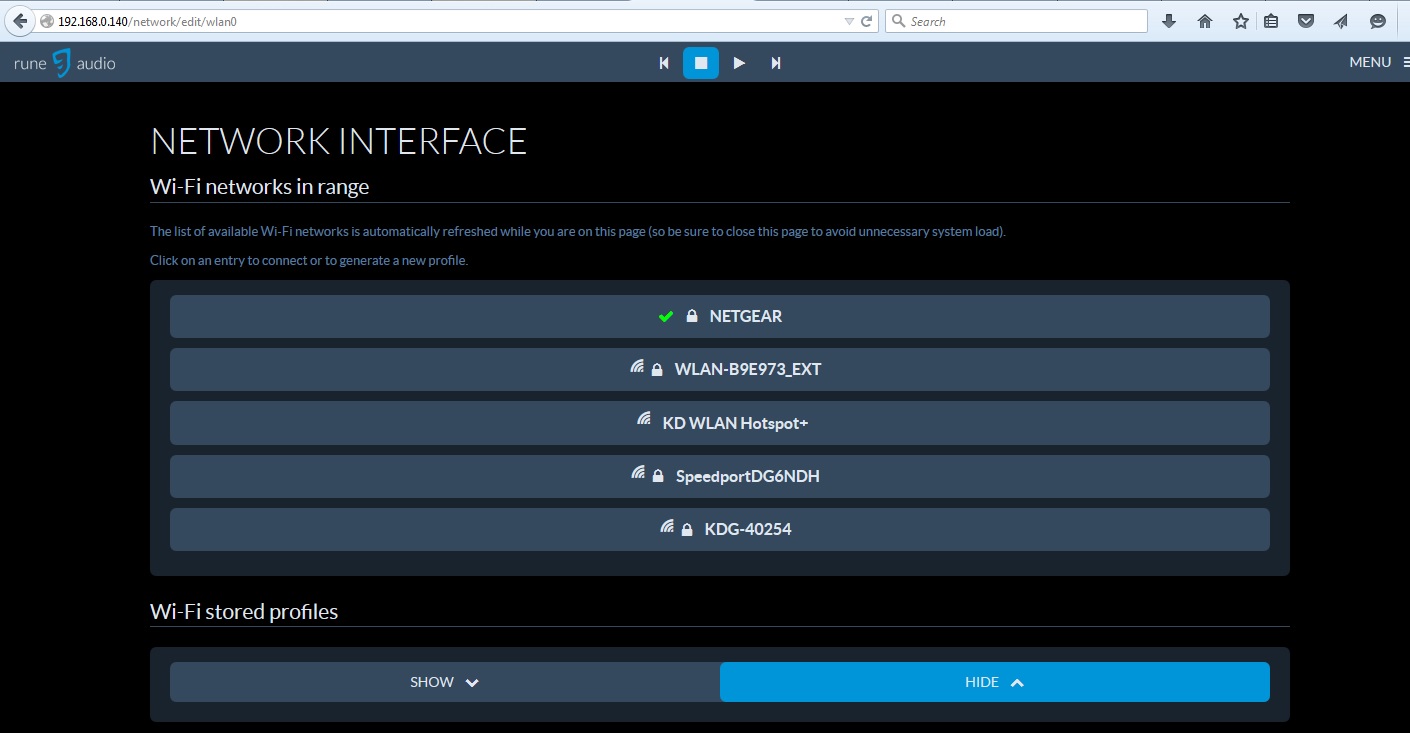

- NW3.jpg (101.59 KiB) Viewed 2160 times
- saved the profile
- after a few seconds the scan shows that i'm connected
