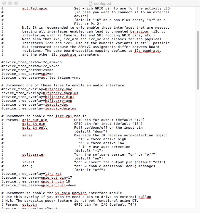

Hi, I'm a total Linux noob so it took me a while to figure out how to edit the /boot/config.txt file. But I've edited it to remove the # from in front of the HifiBerry DAC plus. But it doesn't seem to have any effect on the runeaudio.local dashboard. All I see are USB and HDMI outputs as options. I even tried to uncomment the I2S settings and the other HiFiBerry dac, but those didn't seem to have any effect either. I've enclosed an excerpt from my debug file (full file was too big to fit) and a screen grab of the config.txt file. Can anybody see what I'm doing wrong. Really frustrating to not be able to make my DAC play.
Thanks for any help.
- config.jpg (197.09 KiB) Viewed 7756 times
